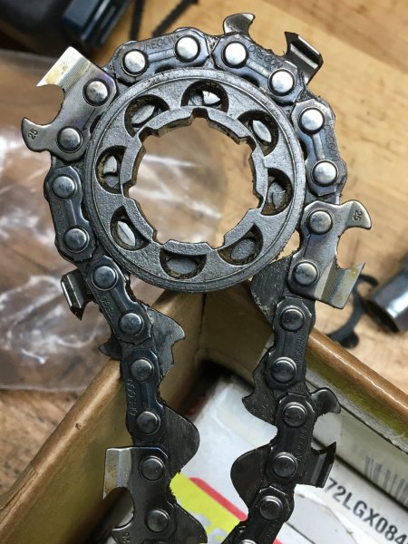

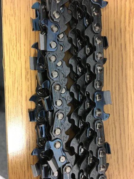

    Anyone ever seen this before?
    619430FB-963E-4AE3-9F78-F18A3EFD9C7D.jpeg EC92CD81-AF45-4DBE-B4F1-97FD8D6CF05B.jpeg
    I have several 32” NIB loops and 1/2 of them had drive links where every other looks uncut. Will this run ok around my rims? One loop was ran and reground, so guy I bought it from at least tried, but he made no mention of the condition.
    1/2 were normal with each driver notched.

    I've have a couple like that, they run just fine.

    Thanks for that! I was picturing those rounded drivers making the chain ride high in the rim.

    To satisfy your concerns, take a rim and drop them in it.

    now why would they do that (un notched) ? less wear?

    My guess is less to machine.

    Did Oregon say it was a boo-boo? It looks really weird. If 99.9999% of DLs out there need a quarter moon shaved out, why don't these?

    Guy on ope said it happened a long time ago and Oregon bought back chains from dealers. Referred to it as rudder chain.
    I have no idea why it would be done. I asked if it was a manufacturing defect and didn’t get an answer. They just simply said they’d replace it.
    Looks like it would be fine. I’ll probably resize the used loop I have and make 16”s to see what it’s like.

    Huh? That's really odd, never seen it before. Looks like it would run fine though. I wonder if those links would carry oil though?
