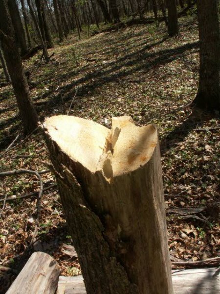

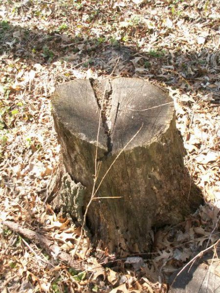

    In over 30 years of felling trees I've used conventional 99.99% of the time,humboldt a few times when logs were extra nice & wanted to preserve as much length & have never even seen a open face before.
    But I do see this quite often around here - both by novices & so called ''professionals'' :hair: :loco: :crazy: :rolleyes: Went for a walk in neighbor's 10 acre woodlot in April 2015 & seen this - Those V cuts make me cringe.The County Road Department is fond of those also,they do that in combination with a big backhoe to push the trees over when removing them from right of ways & along certain bends in gravel roads that are shaded & don't dry out fast enough after rain/snowfall.
    That & the high stumps so many leave kinda pizz me off....;)

    I see those around here all the time as well. That frenching stuff sure makes me angry. Your county road crews must have trained at the same place as the ones around here.

    Aaaahhhh very nice stumps here if the neighbore put and some chairs around will be a high design table :rofl: :lol::rofl: :lol:
