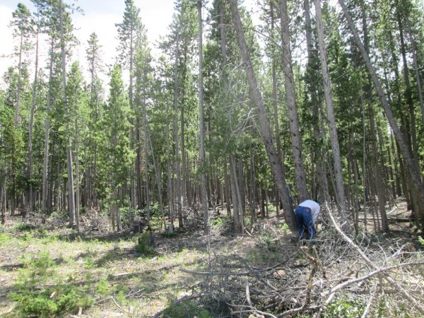

    This was a pretty good leaner I cut last year. No barber chair. The trunk of the tree was pretty solid and it came down with no issue.
