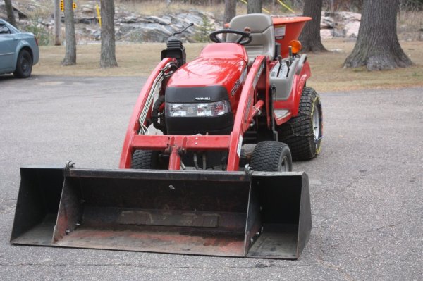

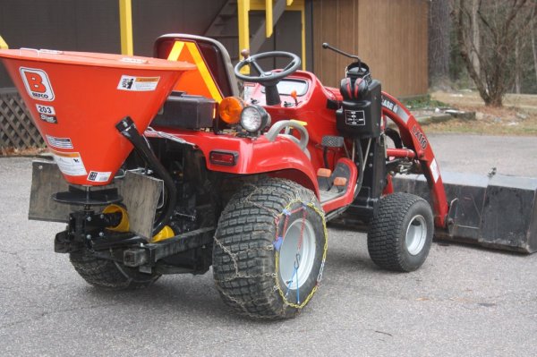

    My sub compact 25 hp 4wd diesel keeps my one acre lot with 3600 sq ft of driveway clean and green. Fits in one bay of a two car garage. Snow Tractor 001.jpg Snow Tractor 002.jpg
    raybonz, swags and SolarandWood like this.
