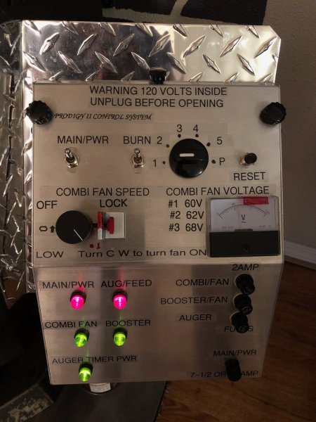

    Came out this morning to fill the wee stove and went to shut the feed off to clean the pot a bit and I noticed that the Fan speed lock was almost falling off the panel.
    OK
    Going to have to make a good fix on that one.

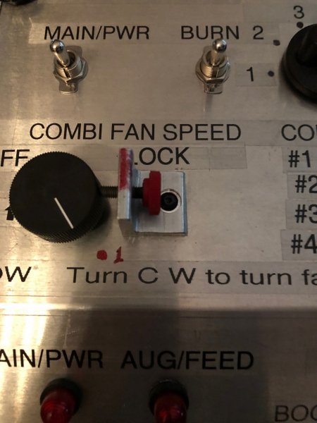

    I had originally not planned on the lock, but the little knob is such that it can be moved easily by accident or KIDS
    SO...Originally I used double sided 3M tape to secure the little bracket....:(
    BAD JUMP.... over time with the small tension of the thumb screw the tape was letting go....
    Shut things down and unplugged the stove.... opened the controller and scoped out where and if I could drill a small hole in the bracket and the panel and add an Allen screw with a nut on the inside.
    Plenty of room, just needed to place a piece of wood between the wiring and the panel front to keep from drilling into the wires.
    Located the hole and then the Red thumb screw would not pass over the screw head..... counter bored the hole to make room.
    Added new tape and the screw.... All good to go.
    Don't think this will ever be an issue again..... :yes:
