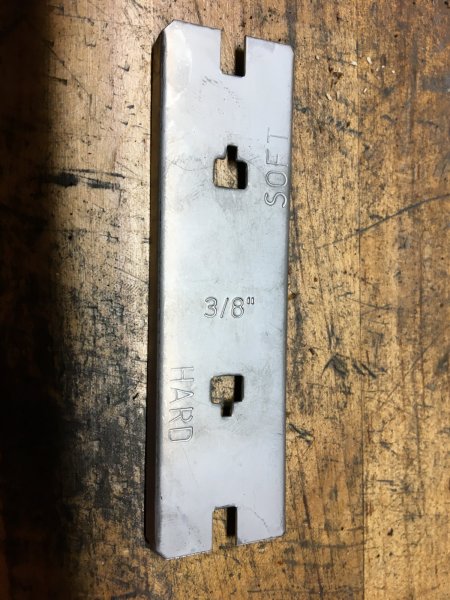

    If you start using a progressive raker gauge, your chain will cut straight no matter how different you file each tooth. If you use any other method, it’ll go crooked if you file one side more that the other. Cheap little tool.
