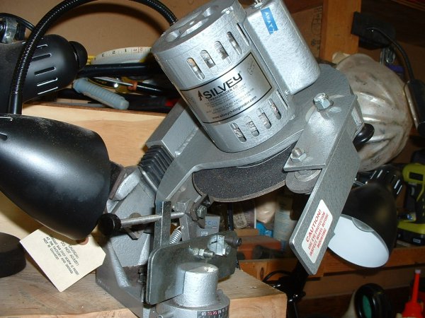

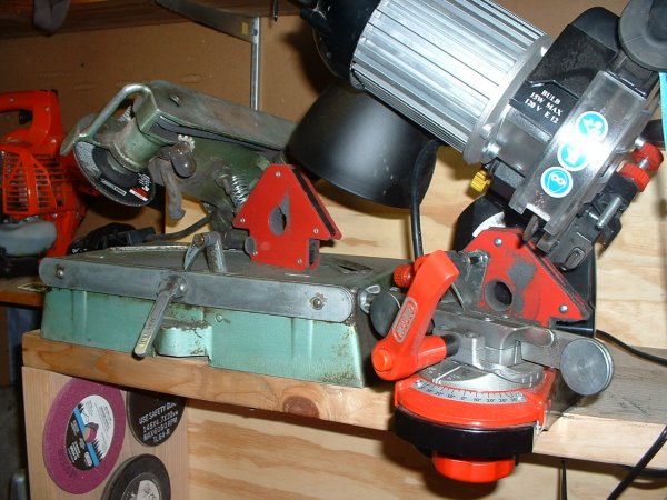

    There are very very few shops sharpening chains that have high end grinders now days. What most are using is something the consumer could buy for not a lot of money. The Tecomec clones are virtually the same thing as the offerings from Oregon. Actually they make Oregon. All have the same weakness and that is the accuracy and means in which the chain is held from the bottom rather than being forced into the groove from the top like Silvey. If buying, get one with a full sized wheel.
    Timber Tuff Upright Bench Mount Electric Chainsaw Chain Sharpener | Blain's Farm & Fleet
    There aren't a lot of these around anymore except on my bench.:whistle::p
    I've got an experimental one with a Silvey style vice that is set up for rakers right now but not in this pic DSCF0014.JPG DSCF0011.JPG DSCF0016.JPG .
