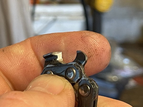

    Well I got the jig I thought it would be weeks, got it in 6-days lol…
    Anyway did a 20” chain for the 362 yesterday and WOW cut like a dream!!!
    The pic I just posted is a 28” chain for my ms 461 (I love that saw lol), anyway I can’t wait to let he eat….I doubt it will be today been cutting and splitting past dark all week need a rest day lol….
    There is a lot of room for a more aggressive/less aggressive cutters I’m just getting a baseline and can always tweak it from there….ive always wanted a way to do square other than file and this is the ticket!!
    I will say if this is the very first geo set someone buys and they don’t have experience with the grinder it will be a lot to take in at first….people that’s been doing chains on the grinders for awhile will be more prepared, naturally…

    I think the only advantage to stone wheels in this application is you can play with the side plate angle. Last week I sharpened a couple chains with a steeper angle dressed on the wheel, to give the side plate more forward lean. I'll see how they do at some point here. But yeah breathing the dust sucks, the grit everywhere sucks (especially in the groove on this jig) You're right too, quick taps rather than plunging into a cutter is the way to go. It's tedious but better than overheating a cutter, and since you have to physically hold the chain with this jig, you don't want to be holding a smoldering hot chain in place anyway.

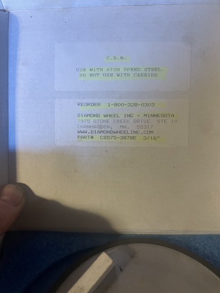

    Would you share a pic of the profile of that cbn wheel? Curious what ya have there.

    I’ll grab one tomorrow, you can go to that guys page “Squarejig” and see the wheel..
  16. The Wood Wolverine
    18,921
    122,022
    Ok. That pic doesn't show the profile but no biggie.. carry on.

    I’ll get a pic for ya later sir…

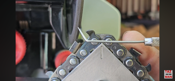

  18. Khntr85
    Khntr85
    Feb 28, 2016
    483
    1,376
    Indiana
