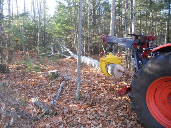

    I had a nice idle with the chain stopped, then after working the saw (cutting) it was completely different and I was unable to smooth it out. Today, while in the woods, I had to put it down before I threw it down! I had to pull the 044 off the tractor. I've gotta find some locally that will teach me the finer points of them 3 effin screws. DSCN7621.JPG
