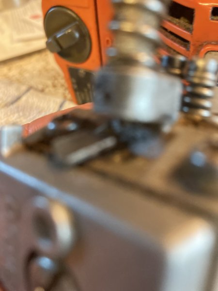

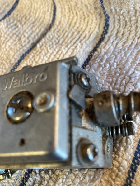

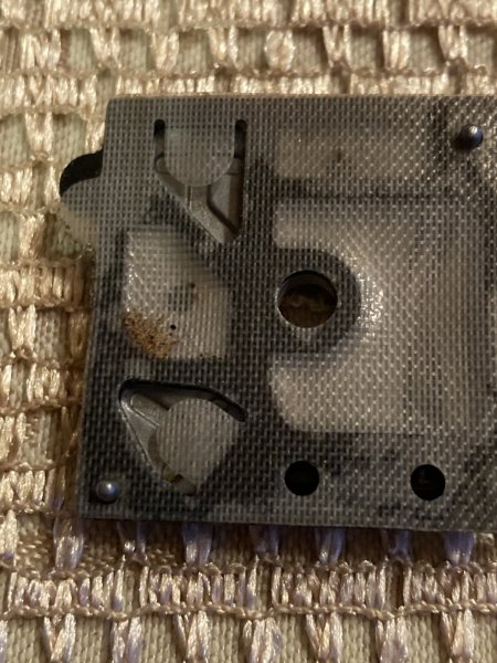

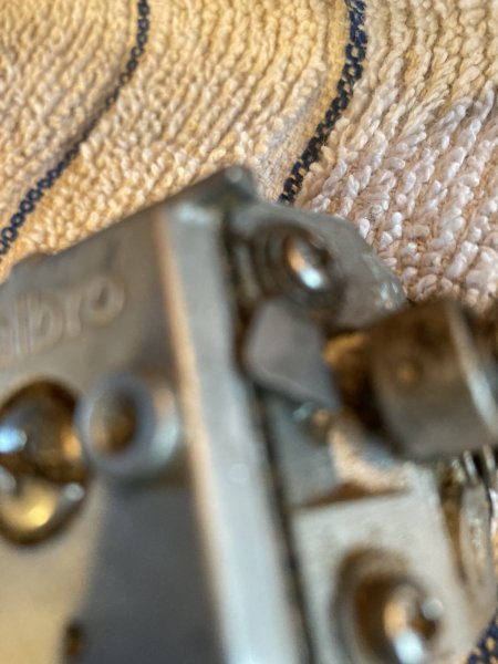

    The metal piece attached by a screw under the idle screw. What is it? What it’s purpose?
    Does it look like it’s in the proper position?

    Let me get my readers out and re-look.

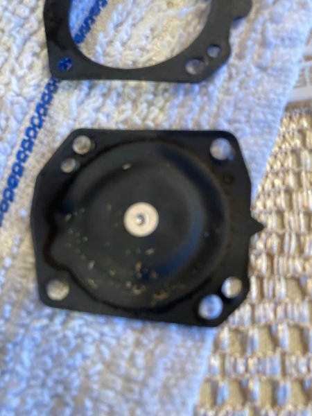

    Is it normal to find debris on this?

    Tough to see in pictures but it looks like the throttle shaft lever that your idle screw rides against to set your idle and yes that is normal to find dust on the diaphragm it usually has a small hole in the metal cover to vent the pump and sawdust does find its way in there JB

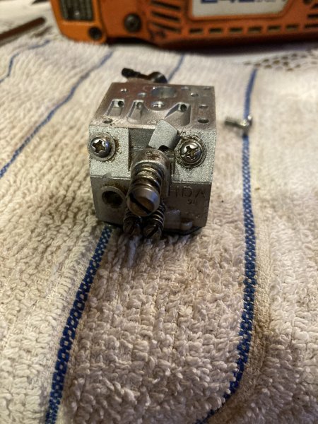

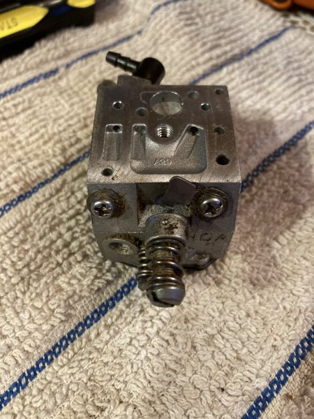

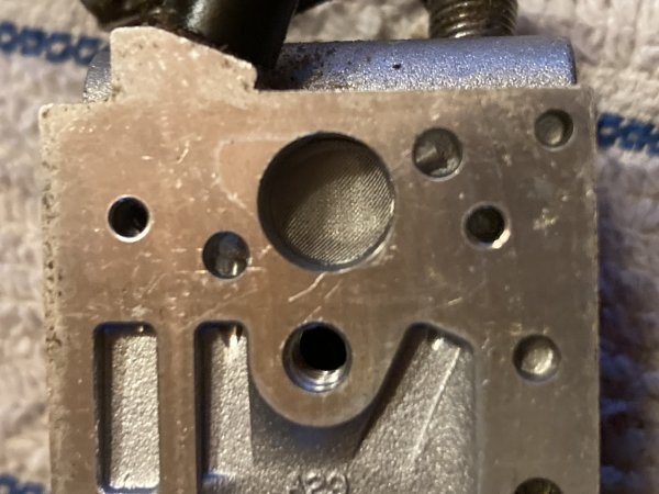

    A few more pics of it. If I turned idle screw way in it won’t make contact with the mystery piece

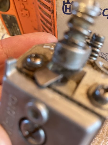

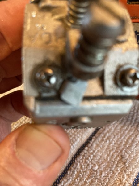

    Screens clean

    idle screw cone needs make contact at some point to move the throttle plate off its seat.
    If it doesn’t at all, see if you loosen the shaft screw and adjust the mystery metal to where it will make contact and stay there after you re tighten the screw.
    If you can, tune the plate location so you’ve got idle screw adjustment for the length of the cone.
    You shouldn’t need all of it, but take advantage of the adjustment capabilities
    In that last picture it looks like you’ve got some mercy in the screw to use up still

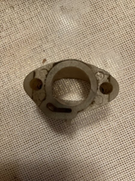

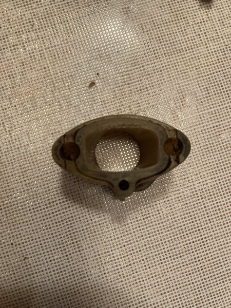

    Another question about the intake block?
    It’s been awhile since disassembly and I don’t remember orientation for the block. Which side faces cylinder

    Match impulse holes, cylinder and carb.
    Should be circle end against the carb and rectangle to the cylinder

    Thanks I figured it out. When the choke is set it’s pulled away from idle screw.

    That makes kindergarten sense. Can’t fit a square block in a circle hole. Thanks

    That's your idle adjustment plate. And yea it won't be in contact with the screen if the choke is on....

    Is it me or does this screen look like there's a bit of shmutz caked on there? Varnish from old fuel perhaps? Could use a soaking in some brake cleaner maybe?
