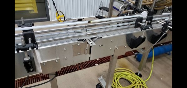

    From this:

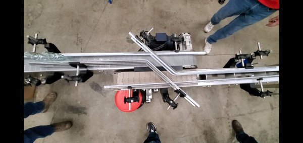

    To this:
    Label changes, normally we have someone pull from the line and set them on rolling shelves...No Bueno with 80 bottles per minute and needing about 4-5 minutes to swap rolls.
    We looked into a rotory 48" and while appealing, seemed to be a hassle to get around and might not be big enough. The 4' x 10' wash table seemed like a likely candidate. Right now I have the right side of the coveyor setup on my Bridgeport cutting relief of the 90° direction change on the entry and side transfer on the exit. I'm also drilling and tapping holes for the "snubber" (support) plates and body brackets and side transfer filler plates. I am videoing this mod to the wash table and will post it once it's done to help with understanding.

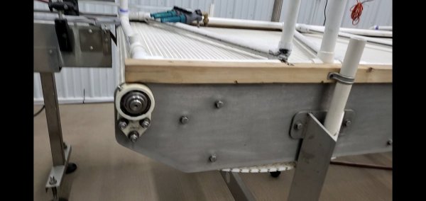

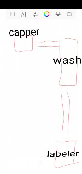

    Here is the only pic I have of the wash table before we took it apart. The entrance, from a conveyor feeding from 90°, will be approx 6" from the end with the bearing but just shy of the support with a prototype bottle zig-zag set up. This is an opening of 14", sort of like the sketch below.

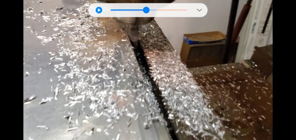

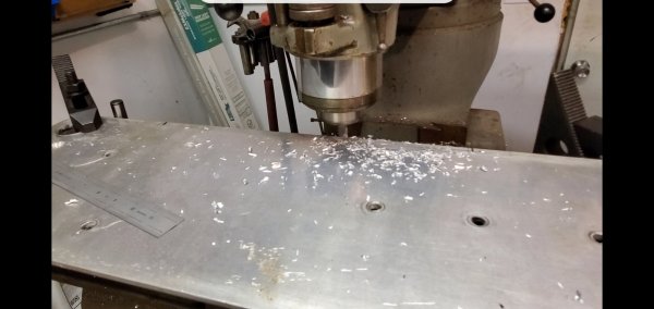

    I have some video to upload to YouTube but here's a screen shot of the relief cut to allow a side transfer. The relief cut is to remove the rail that extends .325" above the top of the conveyor surface. It has to be flush with infeed conveyor and a turntable that helps with the 90° turn. You can see the top of the rail on the far side, below the long run of PVC. Running into some clearance issues with the stand mounts. We'll get that cleared up this morning.

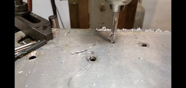

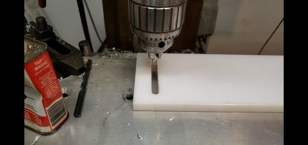

    Snubber plate position and view of rail undercut. Also, shows one small cross support hole clearance issue to the lower left corner of white plate. Also, a pic of the power-tapped hole to mount plate.

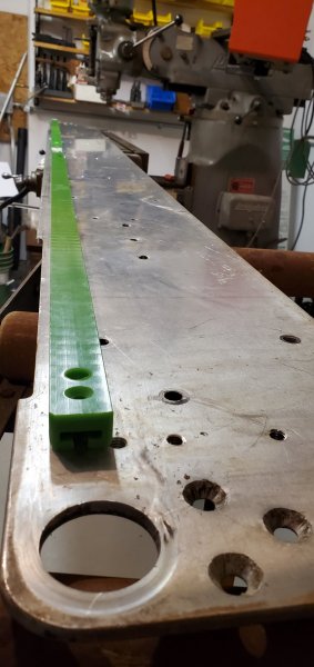

    Is that green hyfax material we are looking at there in the last pic?
