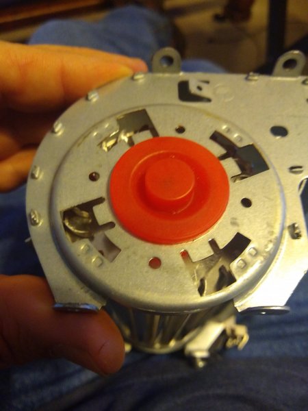

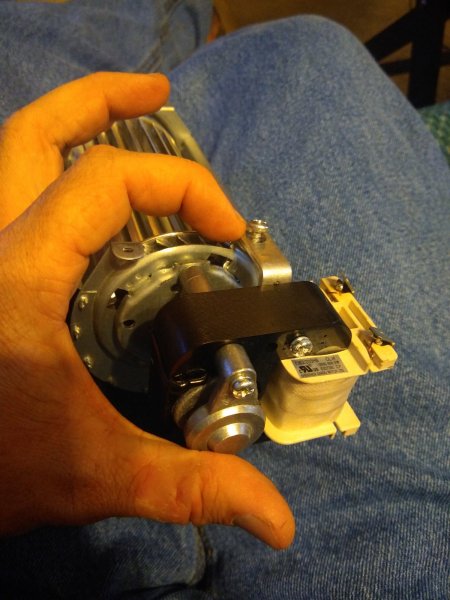

  13. clemsonfor
    clemsonfor
    15,996
    37,478
    Greenwood county SC
    Ok the motor came in. We have excellent Prime service around here. It's normal. I ordered it whatever day I said I did. That's about normal these days for prime, it takes 4 to 10 days usually to get most prime things.
    The motor is the wrong side for the one that I removed. It will work for the other side. BUT if you look at the picture the motor looks like it turns in counter clockwise to the housing with tabs. The screw I'm pointing to looks like it just keep it from backing off. I have not got it loose from the housing yet but I believe bi can get it off. The other side has the same cutout tabs to interlock with the motor mounts. The far side has a silicone stopper with a brass bushing that the saft rides in. Looks like you just pull motor off slide shaft out, pull the plug out stick it through on the other side and twist motor to lock on the other side and then put the end cap back on the other side. 16297562209604044884602164905979.jpg 16297564569126239708568813685587.jpg

  14. Eric VW
    24,566
    141,738
    Not for a grounding point?

  15. brenndatomu
    25,302
    164,714
    Won't that leave the whole thing turning the wrong way? Or can the motor direction be reversed? I seen that some of these are that way

  16. clemsonfor
    clemsonfor
    15,996
    37,478
    Greenwood county SC
    Could be but that bracket also keeps that motor from coming loose as well.

  17. clemsonfor
    clemsonfor
    15,996
    37,478
    Greenwood county SC
    I think it will turn the wrong way but if I swap the squirrel cage 180° won't that fix that as well?

  18. brenndatomu
    25,302
    164,714
    Isn't that the same thing as flipping the whole thing end for end? I dunno...its been a long day, and sometimes I can't visualize stuff like this without the part in front of me...

  19. clemsonfor
    clemsonfor
    15,996
    37,478
    Greenwood county SC
    I'm like you it's hard and I don't want to take that much brain power to think it through. It is like flipping end for end but if I just flip it 180° without swapping anything the output won't line up with the Hole in the square housing the motor bolts to which inturn the whole thing bolts to the stove.
