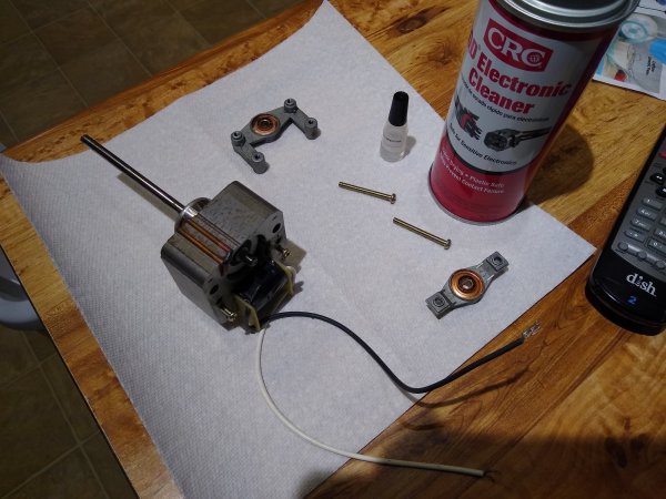

    Pulled the bearings off. Sprayed cleaner on then, blew them. Let dry. Lightly oiled them and reassembled them. Going out to my shed to hook it to power and see if there is a difference. This was the one that barely spun when powers up before. IMG_20210816_181839073.jpg

    This made no difference. Still won't start, sucks power and dims lights . Won't even start with me giving it a spin start.
