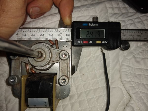

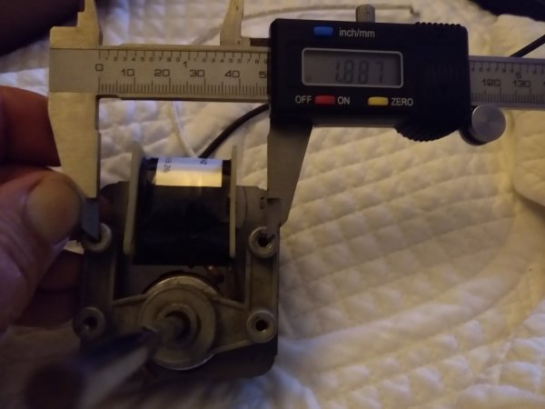

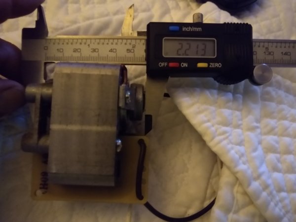

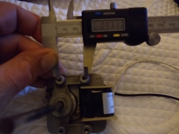

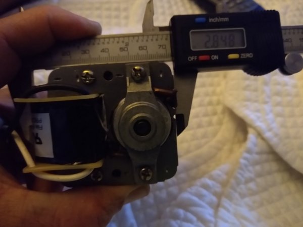

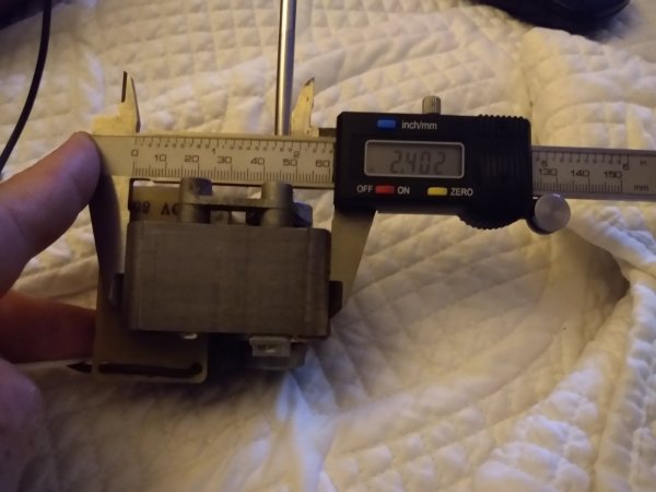

    Here is some pictures. Horkn not sure what measurements you are looking for or just a ball park. I have clearance I believe in there so if it's a bit bigger I think it won't matter but I would have to double check the housing. Here are some Random measurements I took. Also some showing the mounting bolt holes where it mounts to the squirrel cage housing. Those probably are not exact on center measurements for the holes but will be close. IMG_20210815_225820247.jpg IMG_20210815_225644095.jpg IMG_20210815_225516790.jpg IMG_20210815_225455170.jpg IMG_20210815_225413236.jpg IMG_20210815_225343048.jpg IMG_20210815_201618388.jpg

    Yep, after seeing those pics, just take the 2 screws out of the outboard bearing, then it, the inboard bearing, and the whole rotor/shaft assembly can be separated and removed to be cleaned and lubed.
