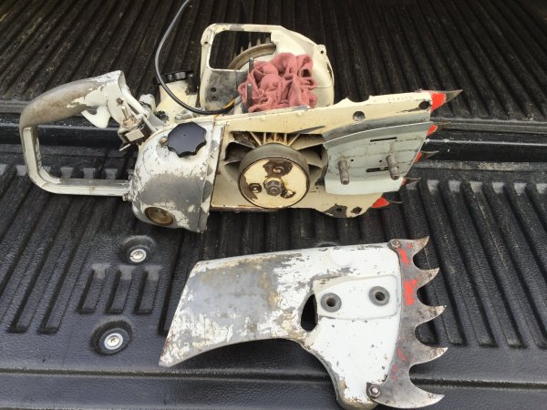

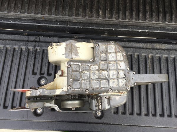

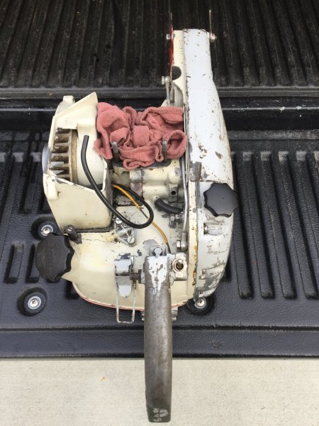

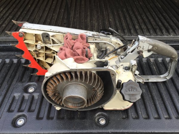

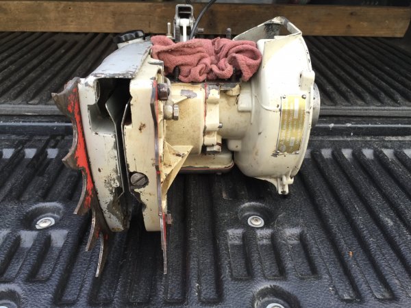

    A few quick shots of the current state of the reassembly process. So far it has new bearings, seals, fuel tank gasket, oil tank gasket, and NOS throttle trigger. After what I've learned about the Contra, mostly from Brad (hdtoolmkr765), it's clear that this is a combination of saws - two or more. The case assembly and bottom plate are the later 'cream' color with serial number is 246,217. The other parts (clutch cover, starter assembly, oil tank, rear handle, etc.) are the earlier 'blue' color. Also, the oil pump and oil tank lack the manual oiling function which Brad tells me joined the club in the 155,xxx range. Either way, it's super cool and I'm anxious for it to breathe again!
