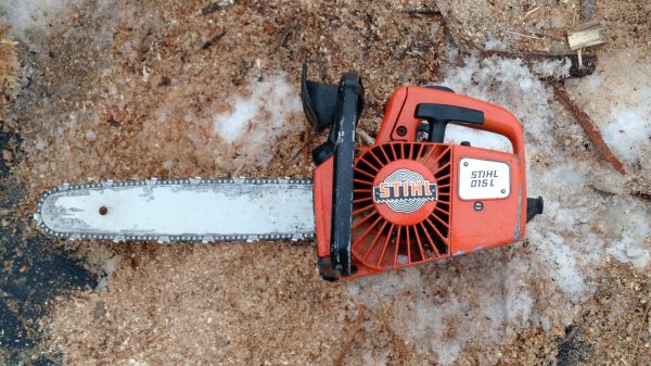

    MMO, pb blaster, eh, all of the other products are nothing compared to kroil. Yes, it's mail order only, but it's literally several times better than any other penetrating oil.
    Seeing that old stihl logo has me wondering when they stopped using the log in the stihl logo?
