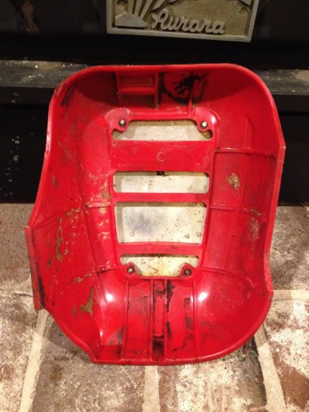

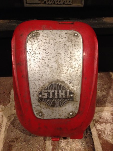

    Dear Diary...
    No shop time today, but it was still a very BIG day for the Contra/Lightning build . . . I got the top cover! I had a choice between the brand new, high quality reproduction top covers many folks use when rebuilding/restoring these saws or this well-used OEM cover. The choice was very easy for two reasons; first, I'm personally just not into aftermarket parts when OEM is an option, and second, why would I want to put a new shiny cover on an old worn saw when I could get one that looks like it was along for the whole ride?!?!
    Here is my 'new' cover right out of the box. It'll get cleaned up a bit, but it's perfect for this project exactly how it is.
