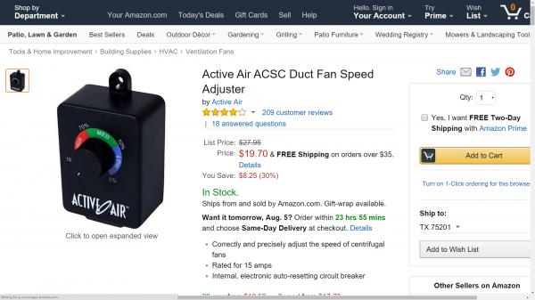

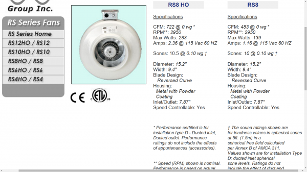

    I have this fan:
    I bought it for my old home. The exhaust fan on our 1972 Jenn Air cooktop died, and we knew all along the run from the stove to the outside was too long. Turns out this was a monster, it almost sucked our food down the exhaust :rofl: :lol: and it sounded like a tornado. We ended up with a different one. I thought I could use this one here for something, but I'd like to turn it down.
    This is the recommended speed dial
    Could I use something like this instead?
  2. concretegrazer
    concretegrazer
    4,429
    12,455
    Southwest MO
    Yes.

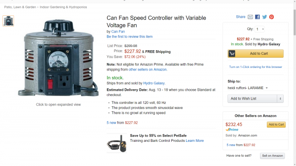

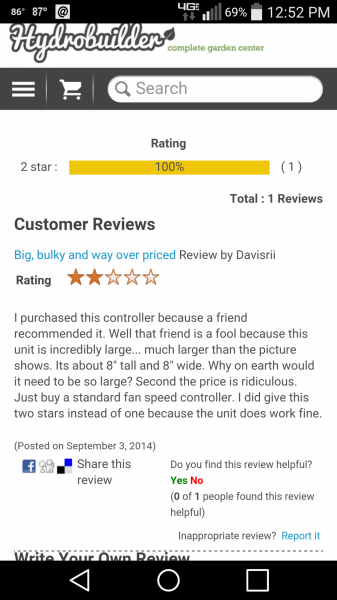

    Why would someone spend $200 instead of $20?
    concretegrazer likes this.
  4. concretegrazer
    concretegrazer
    4,429
    12,455
    Southwest MO
    I have know idea. This review made me laugh.

  6. chris
    chris
    Oct 9, 2013
    3,168
    11,288
    SE WI
    first one is a variable auto transformer, second is your basic SCR type
