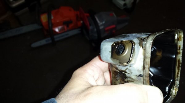

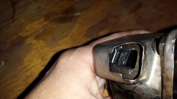

    I finally did my muff mod on the 362C....
    I still kept it conservative. Strato saws are said to not need the drastic opening like standard port saws.
    Lots of room left to open it. I more than doubled the existing hole. But it's still only around 50% of the exhaust port itself.

    Nice work, DD. Did you put the screen back in? How does it sound?

    How much power did that add? Noticeable?

    So you just cut and shape the piece of metal after?

    Are you welding that back in place?

    These new mufflers are 2 piece. They open up and you can grind from inside and outside.
    My daughter had a fever yesterday, so I didn't even start it. I will know today :)
    Yep. I reinstalled the screen. For now anyways. As for the sound, today is the day of reckoning. :thumbs:
    The 362C sounds pretty good as is, but compared to the 441C? It's definitely muffled. This should help it's throttle response and keep it running a little cooler. . . And make it sound better too. :saw:

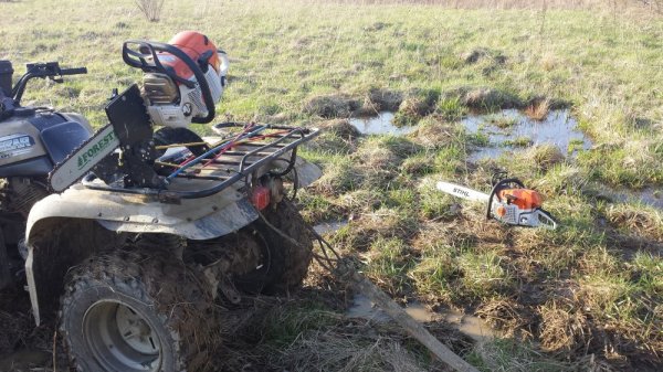

    Cleaned up that last tree that was split at the top yesterday. What a mess. It was split, and leaning against a dead tree itself. Not an ideal cutting situation.
    It's a little wet in my yard (last few acres I don't cut and used to have a motocross track and a mud bog for trucks.)

    Careful you don't find yourself vertical with that tow strap hooked up to the back rack.
