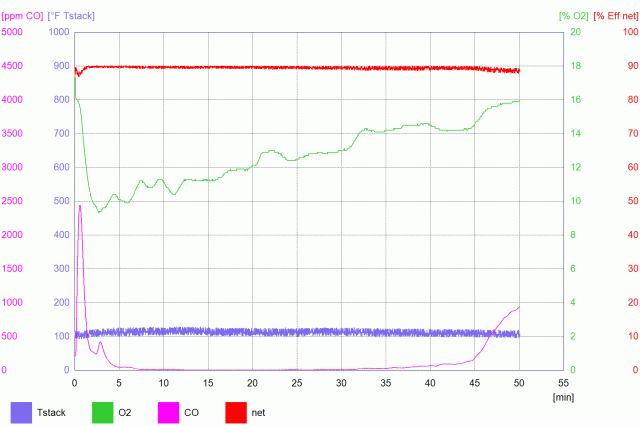

    Very nice! I used to have access to a flue gas analyzer and used it to tune boiler systems. What flue temps do you usually run and what stove do you have?

    Well, my stove is a homemade mass heater, so it's a very different beast than the rest here. Here's a graph from the machine from a run on Tuesday, I'm playing with some new air settings and trying to dial it in. My flue temp is bouncing around about 15°F due to the way the gasses are routed through the mass, but average is about 110°F.

    you came up with a nice chart with numbers, that will work

    That is impressive and something to be proud about! Great job tuning that thing in.

    That's what gas analyzers do you select the fuel type and it provides that info. You can do the hand calcs also but it takes more time.
