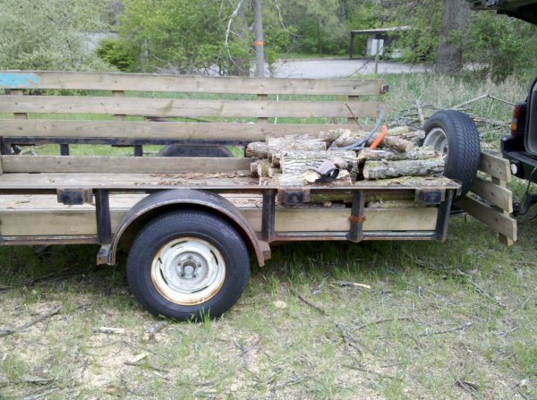

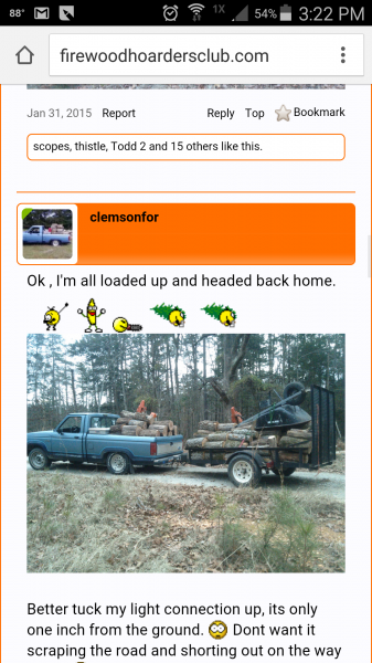

    "Cheap trailers" like this one?? This is actually heavy duty I think for a 4x8. Has 13" tires. Sure has a mesh floor but with a sheet of plywood no problem and I toss it in no problem. It holds about 3/4 cord and that's really more of a load than it should have!
    I thought about putting smaller side boards on it but it would catch more wind. Add to the weight and I can really get more wood on it than is safe. Only time it would help is if you cut a lot of like 6 to 8"rounds or haul a lot of small split wood. Screenshot_2016-04-29-15-22-32.png
