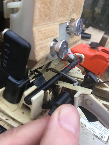

    Stihl Choke Setting.jpg Was tinkering with this today at lunch just to take a look at the carb and condition of the lines myself. I noticed during re-assembly it seems like the thumb actuator for the choke does not engage with the little finger that sticks down from the air filter. Am I missing something during re-assembly that is causing this? I've included a picture with the area in question with a red circle around it. It seems like the thumb lever would not actually engage with and actuate the choke mechanism on the air filter.
    In this image I am pressing downward all the way with my thumb, it doesn't seem to want to go any further.

    I think I figured out that choke/actuator issue at least - when I pulled the carb earlier to inspect and reinstalled it I got the kill-switch wire (not sure of proper terminology here) caught on the back side of the carb and that was keeping the thumb choke mechanism from extending to the point that the little finger actuates the choke in the air filter. Fixed that and got it all put back together, still not running correctly but not running as erratically as yesterday. Just seems to die out once choke is removed, I can keep it going a little by playing with the throttle but it's not usable.

    I just took mine apart to see whats wrong with yours. Broke the black plastic on the handle in the process :hair:. The throttle wire has to hook into the hole on top of the black plastic trigger. I tried to edit so i could draw on the photo but my PC skills are limited. You also have to squeeze the throttle and palm lever to fully engage the choke.
