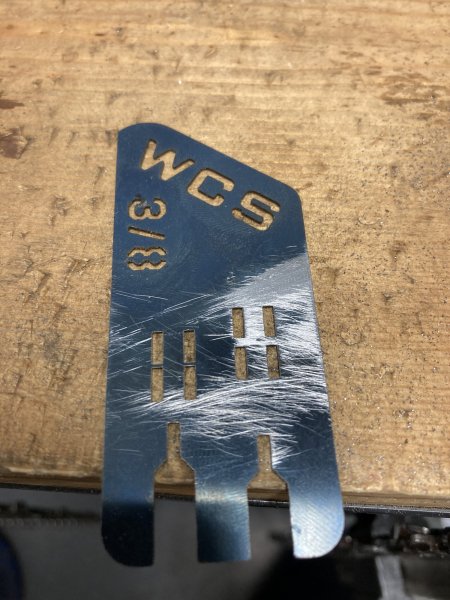

    Okay, stamp 'DUMMY' on my forehead and send me to the home because I can't get this divice to fit on my chain no matter what! It's officially in trash can now.
    Hinerman, Screwloose, Camber and 2 others like this.
  2. Wolley
    Wolley
    Apr 5, 2021
    171
    832
    Maine
    Post a pic if you can. If you have an anti kickback chain with extra rakers this gage might not work.

    Your not Dumb Ralphie, just frustrated. Wood wolverine's pictures explained it perfectly. You are using real chain, it'll work. I'd dig it out of the trash and just find someone in the know. You will be fixed up in less than 30 seconds.

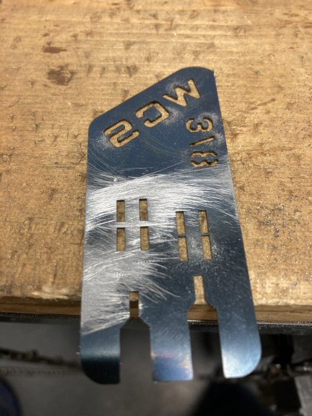

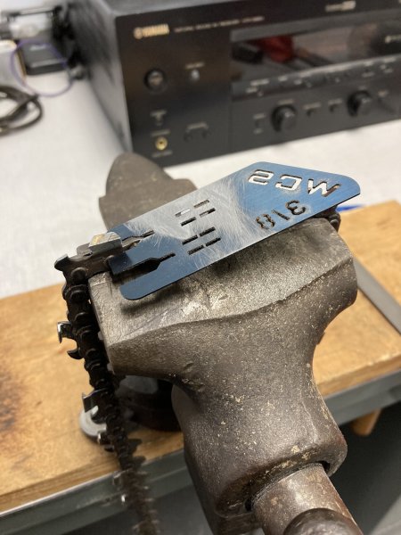

    Finally used the plate. This is after one 28” loop of Oregon EXL that was ran once but not sharpened yet. Only needed a few passes with a file.
    I flipped it from L to R cutters. This shows about the same wear as the stand alone flat Husqvarna plate. Both of which don’t touch the hardness and thickness of the ones on their roller guides. Jury is deliberating for now. I used the “.025” slot to see how it cuts before trying the more aggressive ones.

    I dug mine out of the trash and returned it. We shall see. It would not line up with any chain I have while my Husky progressive gage worked fine.

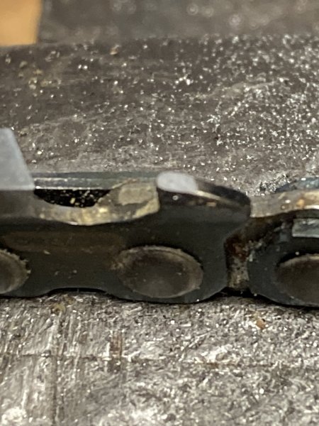

    I think that extra hump is preventing the plate from going all the way down where it needs to sit. I've asked for the first thread to be edited to add not for safety chain.
    In the Huskys, you can see they have an extra wide hole at the spot the hump is, the WCS does not.
    VS:
    Sorry about that Ralphie Boy .

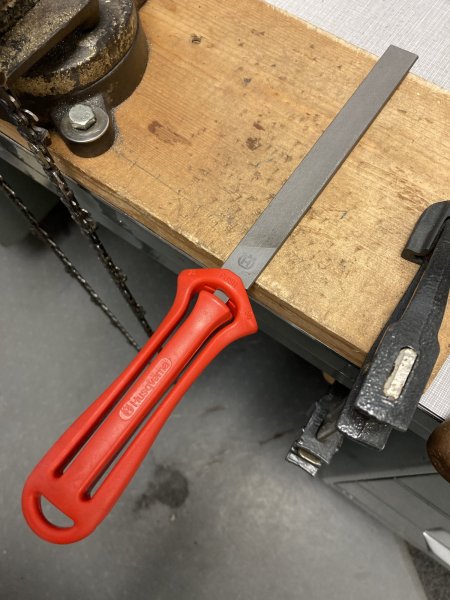

    So a follow up after a bunch of use;
    That slot is working great for me and my conditions(ported saws in hardwood w/ square ground chain). I’ve found that my double bevel files were eating up the metal so I switched to a Husky flat file.
    It’s doing much less damage to the plate so I think I’ll get a decent amount of use from it vs using the other files. I do wish it was a little thicker.
    So to anyone using progressive plates to file rakers/depth gauges, I’d recommend one.
