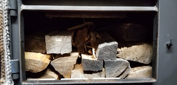

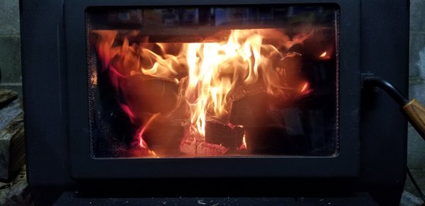

    Top down done right with a short chimney and dead cold stove.....
    Load kindling in a valley on top of smallish splits and i cheat and light with a torch....
    Two photos of 5 minutes of progress, door closed about 30 seconds after lighting.
    and a 15 minute progress pic
