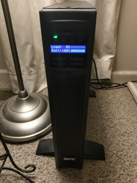

    APC SMX1000 free from work but looks like they are around $500. Works great on my Quad. I'm cheap, if I had to buy one I wouldn't spend this type of coin on one.

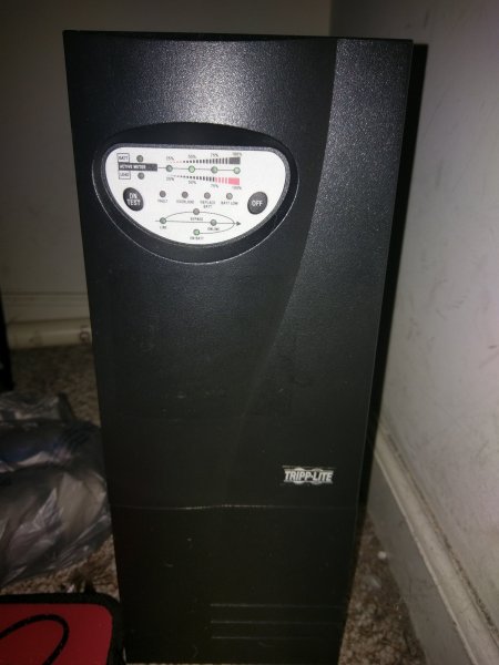

    When I run on generator, I have to use this TrippLite...the APC doesn't like the generator power. I don't leave the TrippLite out all the time because it's too loud in the living room (fans running)
