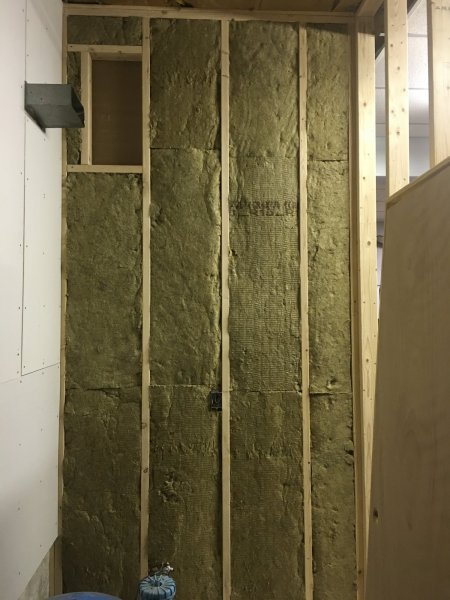

    I'm back at it late this afternoon. Exterior Sheetrock is up and I've got the Roxul in the walls. I'll likely do a bit of the interior rock this evening.
    Most of the electrical is roughed in now as well.

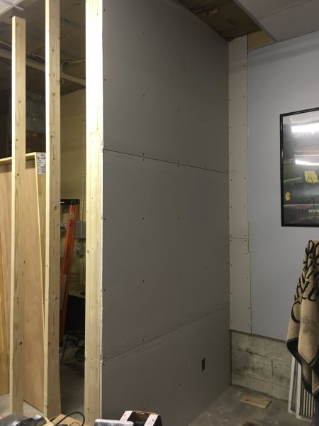

    Here is a "State of the Utility Room" photo for tonight. Exactly four more panels to hang and then on to the next step.
