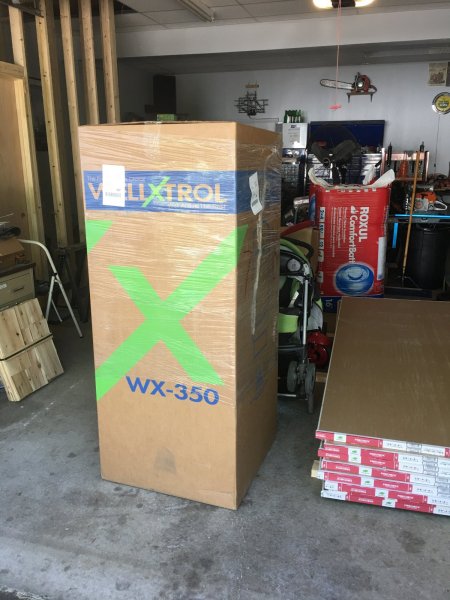

    Delivery day today!
    Hehehehe! :D
    Move over Scotty Overkill, we got a new overkill kid in town! :rofl: :lol::rofl: :lol::rofl: :lol:
    Ain't she a beaut?! o_O :dex::dex::dex:

    what a pressure tank:jaw: how big is house? how many women?

    1280sq ft Ranch, 3BR/1Bath. My wife, three boys (4, 2, and 2 months) and the biggest girl of all, ME. I like my showers. :emb: So not that big of a house. But there were multiple reasons to go big with the tank.
    First and foremost, I am a red-blooded American male. :D:picard:
    After calculating the size tank I would need for my well pump (WX251) the price difference to upgrade to the bigger tank was not all that significant. I have a 1hp pump, so we want the pump to run for at least 2 min before it cuts out. Smaller pumps can get away with 1 min but longer is better. (@EricVW, I heard that! :p)
    I also wanted a sizable amount of reserve so that in the event of a power outage, I do not need to run the generator to maintain a small amount of water on reserve, i.e: toilet will flush a few times overnight without the generator running.
    And also, since I am on a well, and the iron filter requires a fairly hefty flow for backwashing (much more than the softener), the jumbo tank will allow a high-flow surge in the beginning of the backwash and sustain it longer than a smaller tank would before I am relying on the pump alone to provide sufficient flow. This should help "fluff" the media bed and allow a more thorough backwash.

    I thought of that but that's another $900, yeah, the filter is more expensive than the softener. And then the softener becomes the limiting point and this thing just keeps snowballing! But in a single bathroom home, I doubt we'll see a huge pressure drop. Both the softener and the filter are rated to flow more than the old softener did so I shouldn't get any complaints. I hope.
    Yes, pump is submersible, 1hp 5gpm 330 feet down.
    Not really trying to get more water to the fixtures but with the pump upgrade and the increased demand of the filter backwash, I didn't want to be giving up flow to the 3/4" mains. I'm already running 40/60 on the pressure switch, I may experiment with 50/60 since this pressure tank is so massive but it will cut down my drawdown capacity big time.
