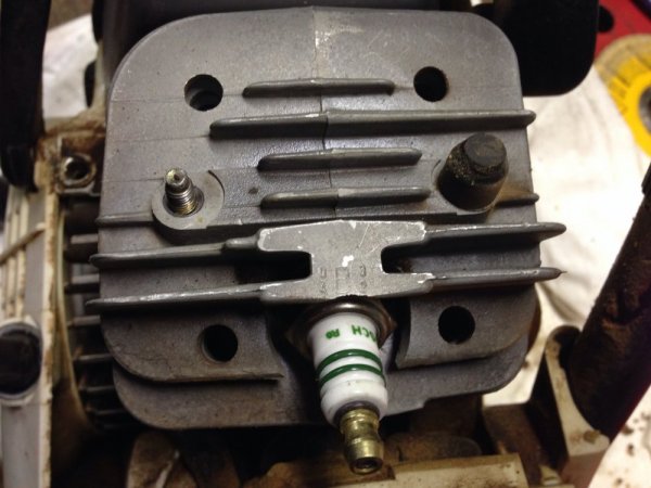

    My non-pro 036 does not have a decompression hole. It was an original cylinder. I have seen 1 48mm (034Super/036) AM jug that didn't have a decomp hole, but Dex is right that most new AM 48mm jugs have a hole and come with a plug.
    I'm thinking that's an original cylinder, but you'll have to clean up around the base and look for Mahle or Stihl to make sure. Or you could rip it apart and see what exactly the previous owner put into it.

    Here's what my 034 AV looks like. It's completely stock.....
