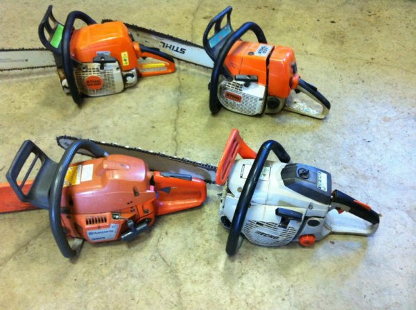

    More testing:
    All tested saws run perfect and were tested cold at WOT.
    036-110 lbs
    Echo cs510-120 lbs
    Friend's (good) old Husq 350-110 lbs
    Friend's like new 290- 130 lbs

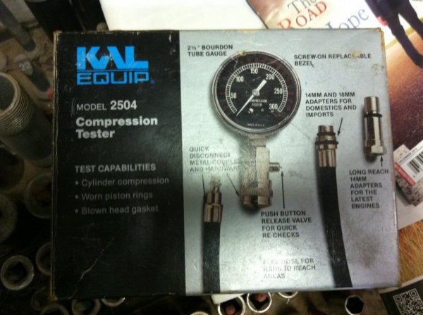

    I'm doubting the comp tester. It is made in the USA though. Correction: it's old in box not NIB. It does hold the pressure until the Schrader valve is pushed.

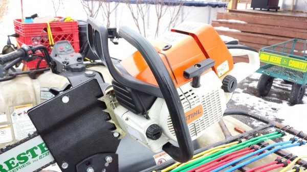

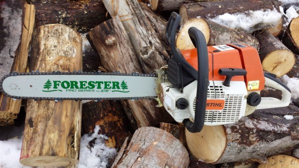

    The 441C-M :) Boxed up and shipping Monday.
    As for the 036, here is my low hour (sticker still on front case) :)
    I just put some Cabers in it, deleted base gasket, and opened the intake and exhaust up. If I get a minute, I will try and get a compression#, but it's only had 3/4 tank since New Caber rings.

    O-rings looked good. Also tried a second comp tester, it- 90 lbs:confused:.
    We cut wood all day yesterday with all four saws that were tested, all started/idled/ran perfect. I don't think a saw with 90-110 lbs of comp would start worth a crap would it? At least one gauge is wrong, I'm doubting both of them.

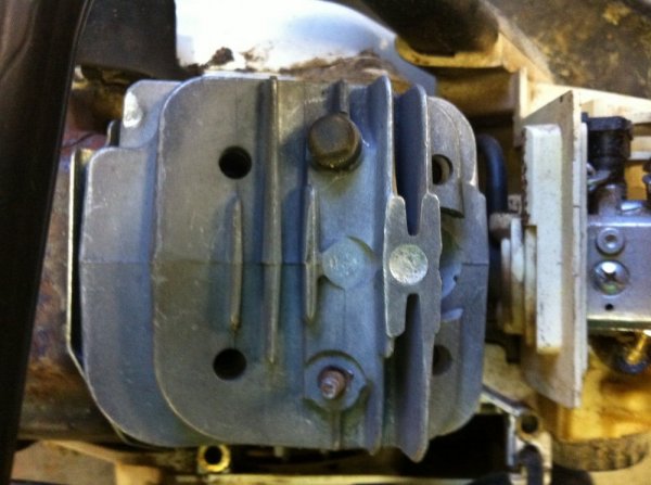

    I expected to see a plug where the decomp button goes on the pro model. Is this an aftermarket jug?
  17. DexterDay
    DexterDay Administrator
    12,411
    31,637
    Northeast Oh
    Do you see Mahle or Stihl in the casting anywhere near the base of the cyl?
  18. DexterDay
    12,411
    31,637
    Northeast Oh
    It could be a standard 036 cyl (no decomp), but will still see Mahle or Stihl in the cast.
  19. fox9988
    fox9988
    2,710
    8,287
    NW Arkansas 72717
    I didn't look. I thought all oem 036 jugs where drilled and tapped for a decomp, and the non pro models had a plug in the hole.
  20. DexterDay
    12,411
    31,637
    Northeast Oh
    Early 034 Super jugs didn't have them, and I thought some of the original 036 (non Pro) didn't have them.
    Now they are all sold with Decomp hole. User either uses plug or decomp, based on model you have.
    I think all aftermarket have a Decomp hole tapped. So it very well could be OEM still.
    Your saw is an early metal tag model and I am almost positive my old metal tag had no hole? I have pics on my PM at home. Gonna have to go back through and look.
