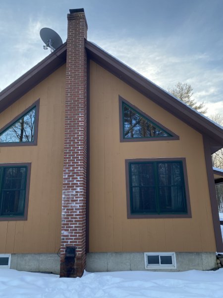

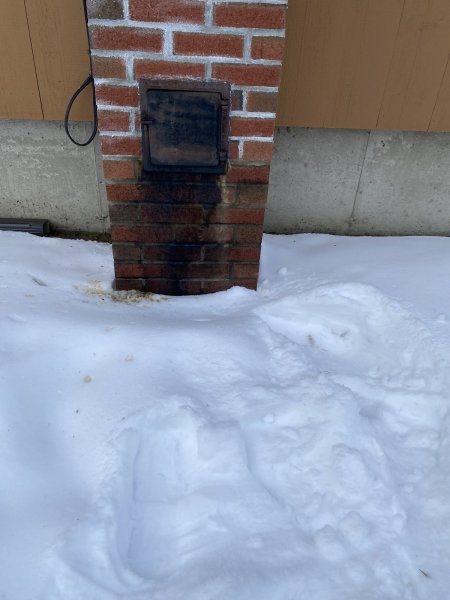

    Oh man...that black below the clean out and the efflorescence on the brick spells lots of condensation to me.
    At some point you should clean and water proof that entire chimney tip top to bottom with a high quality chimney water proofing like that of How to Waterproof Your Chimney and Prevent Chimney Leaks - SaverSystems
    You can do it yourself, but you might be better off letting a pro do it. They will have the cleaning products and the water-proofing products of similar and sometimes they have pro products (non-consumer type) as well versus consumer versions, which both can work well.
    I am thinking that chimney could be leaking somewhere. I don’t think that is just from running your stove, but it could be. You certainly can’t lose by having a thorough inspection done by your trustworthy local sweep. The top may be leaking somehow.

    So is it safe to use? Should I stop burning it? I feel like this has been going on for a while now. This is why I’ve been concerned with the condensation. My chimney sweep didn’t say anything about the condensation below the clean out. He did go out there to clean out what fell to the bottom when he cleaned it.

    Id drop an insulated liner down it and call it a day. The masonry, especially on the exterior, is going to absorb all the heat from your flue gasses. Thats why you've got creosote running out the top and bottom of the chimney.
    20' liner, insulation, a T with a removable snout to make the liner installation easy and a new cap. I would also pack the top of the chimney with Rock Wool prior to securing the cap. Itll help keep drafts down.
    ETA: if you have 13x13 clay tiles in there now, no need to remove them. If you have 9x13, you'll have to ovalize the liner to get it down. Save your money on the inspection and put it towards the liner.

    I was running into similar issues before I lined my chimney. I have a 9x12 clay flue, which was clearly oversized for my keystone. On start up, I would get bad condensation that looks like yours. My clean out would be a couple inches deep of liquid creosote and similar efflorescence. Absolutely terrible experience cleaning that daily. Of course the speculation was "wet wood" however I'm typically 3-4 years ahead, and it all lives under cover and 15-20% consistently.
    I don't know what your wood supply looks like, but to me that's step 1. Make sure you have a good seasoned wood supply
    Step 2 would be a liner. I no longer have any condensation issues, so life is good.
