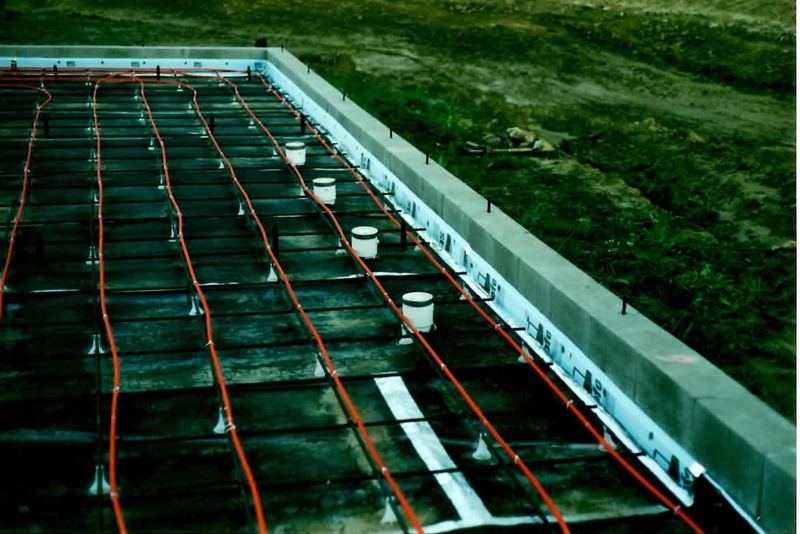

    Thanks. I guess mine does get sort of heated back up before returning as you can see it goes back into the main line from the 7 smaller orange return lines from the garage floors. They turn on and off from their own thermastats and pumps. I know it'll pull the boiler temp down close to 50 degrees till it heats it up.
    It makes for a pretty good heat sync!
