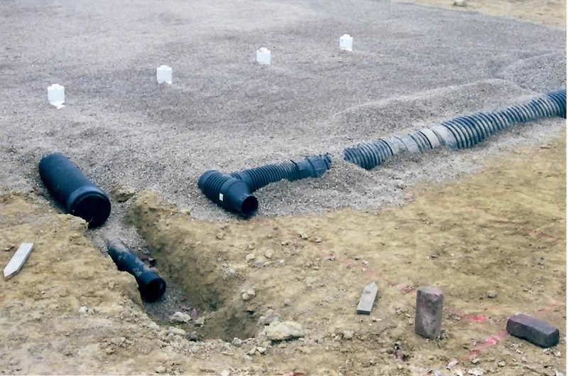

    I'd highly recommend running a 4 inch field tile under it to drain out to a lower location. Surround it all with pea gravel so any water will get away fast. I did that on mine.
    Pic shows it on the lower left. I used smooth bore HI Q pipe so I could easily replace the whole line by just pulling it out. It's going under a 50ft radiant heated garage floor here so no going back to fix if something were to happen. Running perfect for 15 years now.

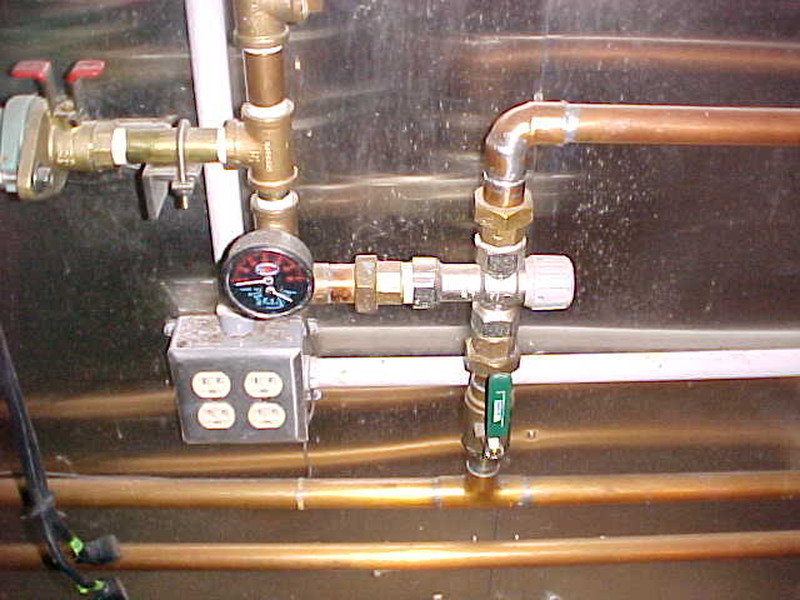

    Forgot the mixing valve he put in too! Im thinking what he meant is that really cool water returned to the boiler would cause issues with the boiler, but not sure, said his experience is with electric boilers not wood ones, figured can't be a bad thing
    Nice setup! Nice and clean, love the look of copper
