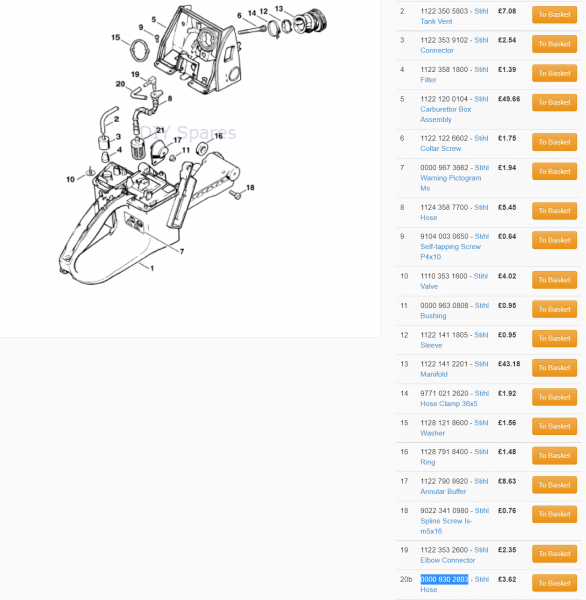

    OEM fuel line is the only way to go. Husqvarna, Echo, Stihl… all very good.
