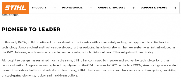

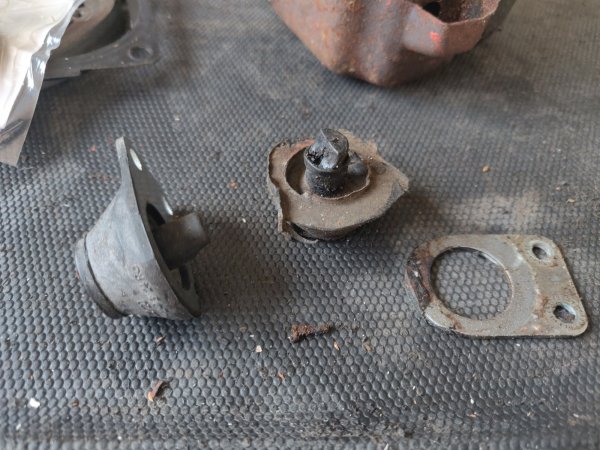

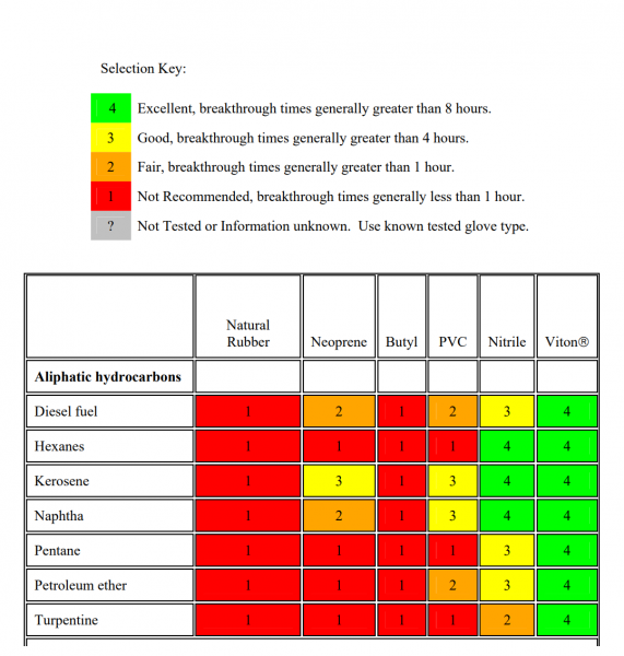

    Worried about anti-vibe bushings as well. They seem very soft to me and made of just rubber......which is not good when it comes to exposure to naphtha.
    Here's a screenshot of a document on glove materials and their resistance to different chemicals.
    From here:
    https://www.augusta.edu/services/ehs/chemsafe/PDF files/gloveselechart.pdf upload_2022-3-10_20-24-3.png

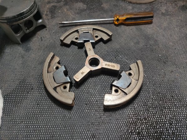

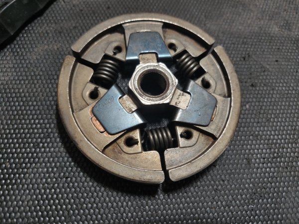

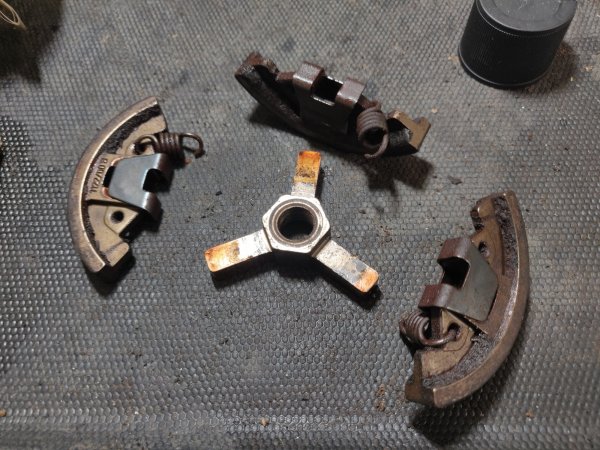

    MS660 clutch before and after a bit of scrubbage with some brake cleaner and a brush. New springs too.
    Do you need to add any lube to the clutch forks? I'm guessing a little spritz of white lithium might do the trick or a drop on each side of 3-in-1 oil.

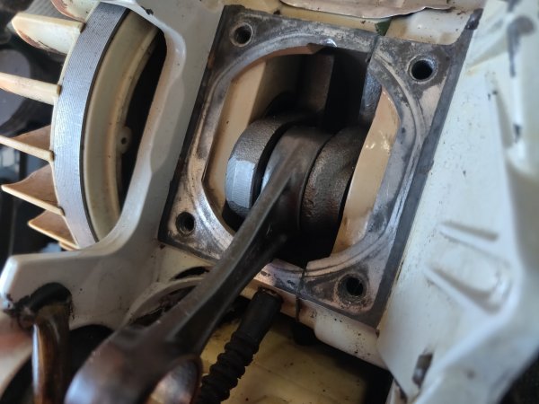

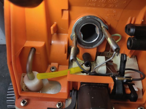

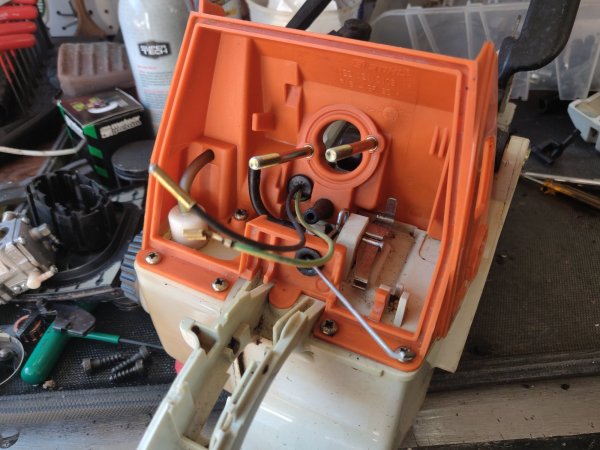

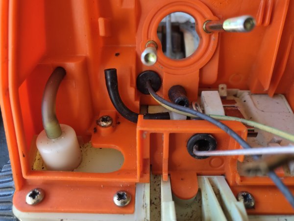

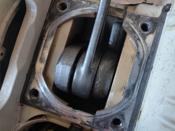

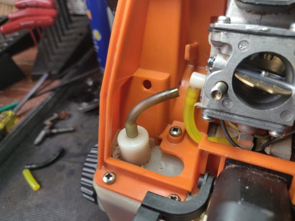

    Got a few things installed. New chain catch, new av bushing near the carb, reinstalled the carb housing, and then I noticed some damage on the cases and it looks like the connecting rod slammed into the cases on both sides front and rear. There doesn't seem to be any damage to the actual connecting rod and there wasn't any damage to the gasket either so I'm trying to figure out how that happened.

  8. BuckthornBonnie
    BuckthornBonnie
    997
    3,318
    Penn Yan, NY
    That spot happens when the cylinder is removed and the rod is free to smack into the softer magnesium. You can watch it happen in the video you posted earlier. I avoid it by protecting open crankcases with paper towel.

  9. BuckthornBonnie
    BuckthornBonnie
    997
    3,318
    Penn Yan, NY
    It doesn’t take much… it’s often found in cases where the previous mechanic had the top end off and didn’t realize the rod is free to move.
    The gasket and sealant should cover that and seal it well.
    If the crankshaft doesn’t have play (any play is bad in ball bearing interference fits) but you still suspect bottom end problems, always remove the coil while ticking it over. Rarely, the crank can feel tight but the bearings (or shaft itself) is shot. A visual inspection and “feel” is the way to go.

    Yep, I done realized I did it like about 10 minutes ago!!!!! Face palm to myself. Rookie move. "HOW DID THIS HAPPEN???? Oh wait a minute........let's go to the video tape........"

    That clear silicone substance is an adhesive Stihl sometimes used on the two-piece carb housing/tanks from 1122 series and others. Decades of fuel and finally a decent cleaning caused it to come off. No worries there.

    Thanks. I was trying to figure out why the heck it was in there in the first place. There are 7 screws holding the plastic in place I doubt it's going anywhere. Were they concerned about air leakage? I don't get it.

    Dust, maybe. I’m not totally sure on that. My 064s had the same problem.
    1122s are bullet-proof saws that will probably go down as one of Stihl’s best series. They’re nearly always worth rebuilding.

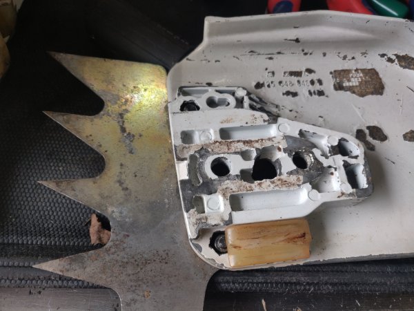

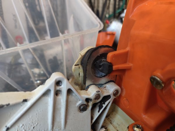

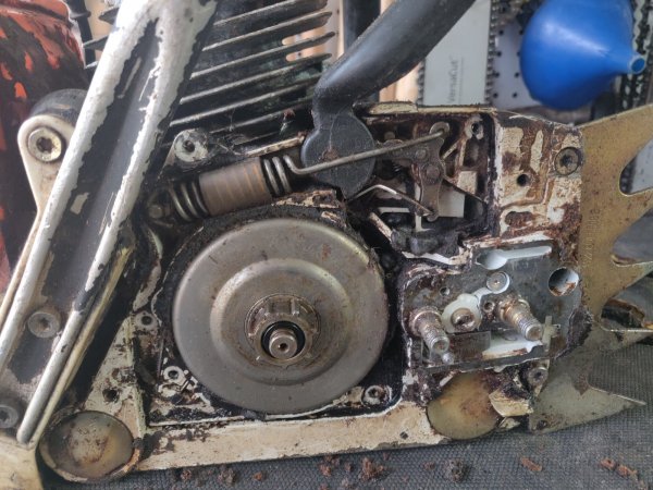

    Here's a pic of where he had bent the chain brake band to "get it to go". I bent it back and it looked ok. Hopefully it doesn't break (no pun intended).

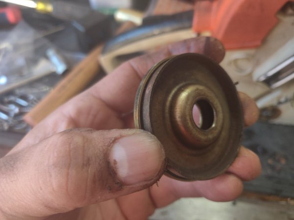

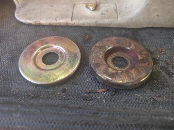

    On an unrelated note, this 028 that I'm rebuilding. I thought it had the wrong washer behind the clutch. Looked up the part, ordered it, but when it arrived it was definitely thinner than the one installed and the center hole was too big which caused it to bind when I reinstalled the clutch. I could not pull the rope at all. I had to put the original one back in there.
    Has this ever happened to you BuckthornBonnie? The one on the right is the older one and it is significantly taller than the one I ordered as well as being slightly less in diameter.
    Part I ordered was 1118 162 1001 based on the ipl. I had thought because of the marks on the original one it was too tall.

  16. BuckthornBonnie
    BuckthornBonnie
    997
    3,318
    Penn Yan, NY
    Yes, but not 1118 series.
    1125 and 1122 had different clutch washers that corresponded to different clutch keepers around the “hub.” If an older style clutch was used with a new style washer, the eclip may not fit and everything would be too tight to come together (even after the clutch was torqued).
    Compare everything and assume that the existing washer is the correct one.

    I would replace that brake band. Metal fatigue is very real and that brake needs to work properly with a 92cc saw in a bucket or in the hands of a groundie.

    Ok will do. Safety first for sure.
