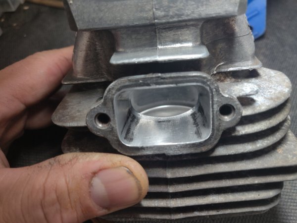

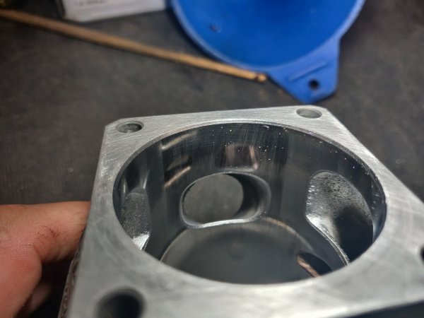

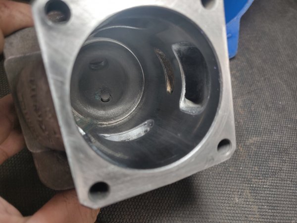

    Well it ain't perfect but pretty good. Got most of the aluminum transfer out of the cylinder walls and got most of the carbon buildup on the exhaust port. There was some orange gasket maker on the muffler port which was weird.
    As I'm waiting for the parts for this MS660 I'll start rebuilding the Husky 372xp tomorrow.

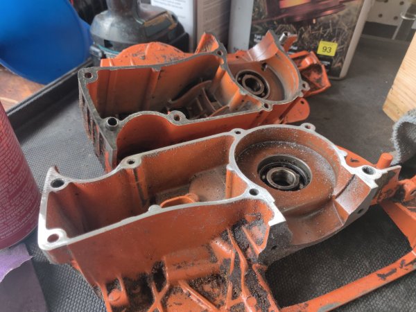

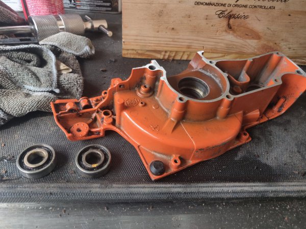

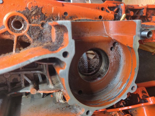

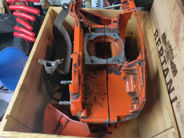

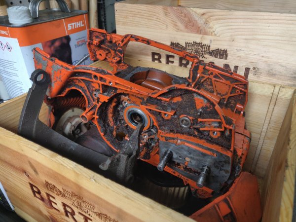

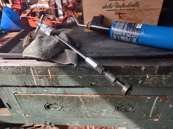

    Took the first steps to rebuilding the 372xp x-torq today. Scraped the case gaskets off with a razor, sanded lightly, and then used my harbor freight bearing puller which works absolutely amazing.
    Only took a few taps after heating it up the case a little. Woo hoo. Waiting for the parts washer. This thing is gross.

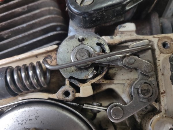

    The only brand new saw I ever purchased was my first one - the Makita 36v 14" cordless back in Oct-2019. I'm currently also overhauling this 028 from ~1983 for my buddy.... Bought it from FBMP and it was missing a whole bunch of stuff......last thing I was waiting for (or so I thought) was a set of new springs for the clutch.....and got them today. After I put them on the chain brake wouldn't engage and I noticed that the one of the 5mm x .7mm e-clips was missing from pivot point below the handle. I'm glad I caught that before giving it to him because I had tested the brake before after replacing the missing spring......and it had worked then.
    You can see the missing clip below.

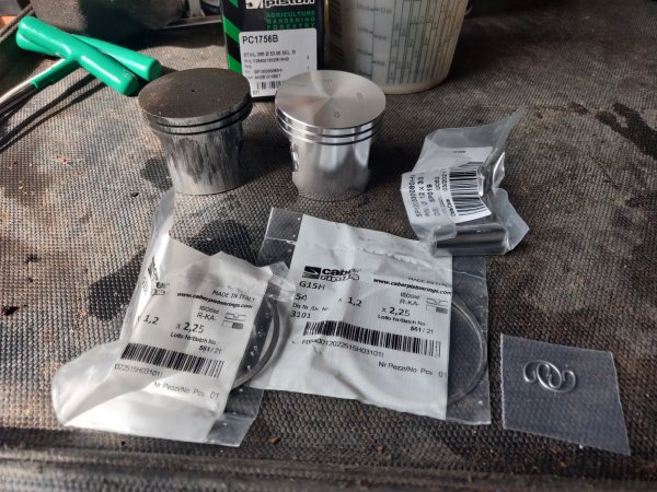

    Ms660 replacement Meteor piston, rings, wrist pin, circ clips.
    Still waiting for the wrist pin bearing.
    Will reuse the old cylinder gasket with some 1184 on both side. Weird how the gasket doesn't fit around the piston. You have to install the gasket first and then the piston.

    If you use the meteor clips, snip the bulk of those big ears off
    Horkn and LordOfTheFlies like this.

    I'm guessing they have a tendency to unclip themselves and cause a catastrophic failure yah? Thanks for the tip will do.

    The added mass can snap off and also can cause them to come unseated. If oem is the same wire diameter I’d go that route

    Thanks. Just as an aside the clips that came with the 372xp Meteor piston did not have those big ears......
