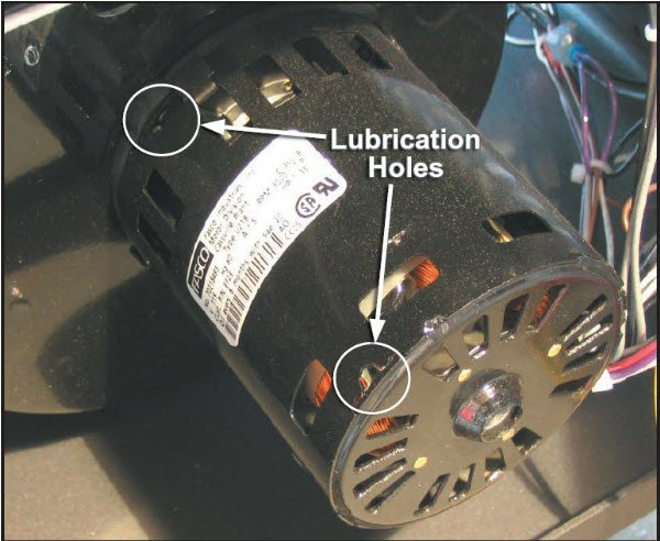

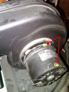

    Could just be a need for some lubrication. You don't say in your signature what kind or model stove you have, but these pics may help with getting some lube into the motor bearings. If you don't see these holes, they may be on the bottom.....motor would have to be removed & rotated or lubed out of the stove. Use 2- 3 drops of light 20w non-detergent oil (read that as NOT car motor oil......3 in 1 oil works in a pinch, but their blue can oil is meant for electric motor bearings:

    imacman,
    The motor looks like mine and I found the two holes.Glad you spelled out what kind of oil to use because I was going to reach for one of my two favorite tools WD40 and the other one being duct tape :). Glad I looked a little harder for the 3 in 1 oil. So I did my weekly cleaning and oiled the motor as in the picture you posted. Will see what happens. I thought that after the start up ignition sequence maybe around 10 minutes or so that blower should kick in. It doesn't do that anymore without a little winding up from the ole back scratcher. It's just random stuff that is happening. Stove will work for an hour or two or maybe even a day and then start blinking a red code. Then I restart a couple of times and off we go for the rest of the week till the next cleaning .... then we go thru the same scenario again.

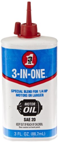

    BTW, for the pellet stove "newbies"....this is what you want to have in your stove "tool kit" for lube:
