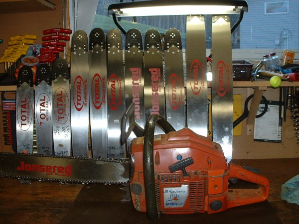

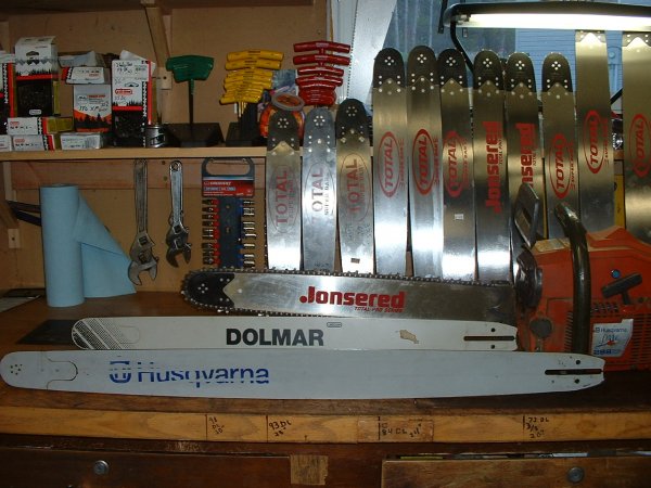

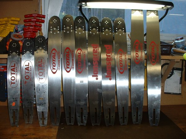

    I've got a pile of Tsmura bars, never greased a one. Got them DSCF0009.JPG DSCF0010.JPG DSCF0011.JPG for $38-42 each so I bought a bunch.
