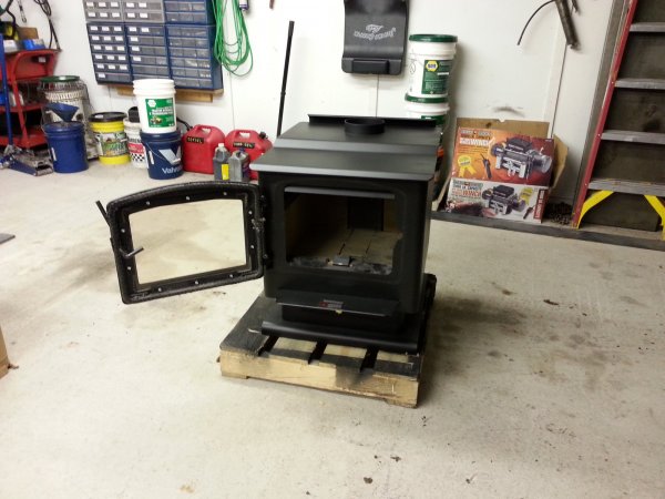

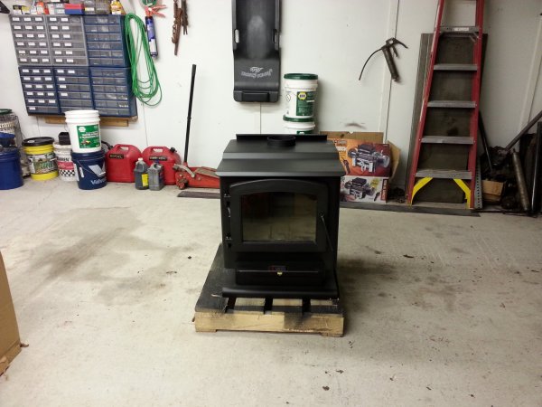

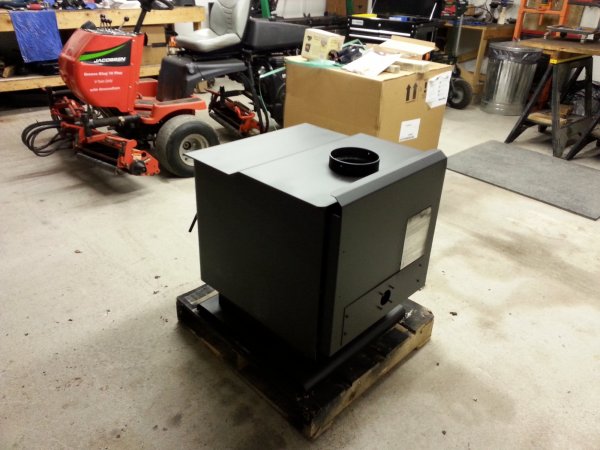

    Should be an interesting day. All buddies are either at deer camp or working. And it just started raining so the ramp is gonna be slick. Pulled the vc out last night and starting on moving in the new one. I'll try to post pics as I go.
    HDRock, wildwest and papadave like this.
  18. papadave
    Just be careful and don't rush. Looking forward to this.
    :popcorn:
  19. Bret Hart
    Bret Hart
    1,062
    3,829
    Central NY
    In and done. I'll start positing pics soon.
