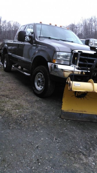

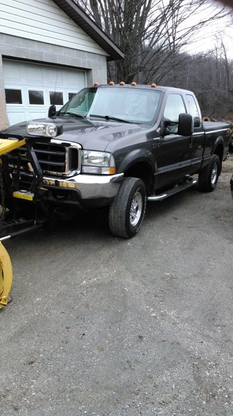

    Gave up on the f350, saw this roadside the other day and it followed me home today. 03 f250 with the 5.4, 129k, short bed which isn't ideal, but I'm not averse to a set of rails so I can scrounge higher. Been dealing with a 6' bed for years, so nothing new.
    One exhaust manifold has been done, the other one is ticking so I'll look into getting it done shortly. Cab corners and rear wheel wells have been done, with steel and glass respectively. Calipers, brake lines, several coil packs are new work. Fluids look and smell good. Minor oil leak at the back of the intake manifold. Tranny is smooth, front end tight.

    Sweet...don't hafta worry about the issues with the cam phaser and 3 piece spark plugs now!
    I was kinda looking for a short bed when I bought mine...I think they are easier to "live with"...turning radius and all...my 8' is nice when you really wanna load 'er up though.
    These things are so dang tall... I can't reach wood in the center of the bed from over the side, and I'm 6' 4"! Thought about switching to a flatbed...even bought a used on, haven't installed yet though. Our new 2017 F250 XL at work is 4" taller even...nuts!
    Clean things up real well, make sure you know where that oil leak is coming from for sure before fixing it. Mine had the oil drip onto the starter and exhaust that is typical of a head gasket leak...turned out it was just an expansion plug in the back of the right head. Couple bucks and a half hour of work it was all better. Fortunately the 5.4 has a little room between the back of the head and the firewall.
