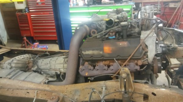

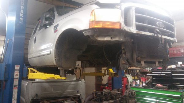

    2V dont really have issues. rear right head is known to have minor oil leaks....oil passage is close to the edge and it was a poor finish on the head and caused the head gasket to leak. right timing chain guide breaks occasionally, makes a pretty good racket with the chain slapping the timing cover so you know it when it breaks. easy fix tho, just replace the guides....we always replaced chains, guides, tensioners anytime we had them opened up.
    I'm trying to figure out how you guys are all coming up with trucks that have had the engines/trans replaced.....cousins car lot sells 300 cars a year with probably close to 50% being ford trucks and we have only replaced a handful of engines and trans combined in 10 yrs. on a diesel i can see transmissions....Rafe that used to work for me replaced the trans in his 01 powerstroke twice in 2 years and its starting to shift funny again so that will be a trans per year for 3 years in a row. he is looking to swap over to a ZF6 like i just did to my truck last fall.

    How long does it take to get the body off like that...always wondered...figure they made it easy since its kind of thing now...

    it was off and rolling the chassis out of the shop for a good pressure wash in under 3 hours by myself. going back on was closer to 14 hours tho....i had all my plow wiring, lights, air compressor, boost gauge, tranny temp, egt gauge, and transfer pump wring all running thru the clutch master cylinder hole in the firewall so it was a total rewire on all my goodies once the cab was back on plus added a fuel pressure gauge and fixed a bunch of small issues in the process. 6 months later and i still havent finished figuring out the wiring to make the cruise work again and the starter is jumpered with a piece of tie wire in the electrical connector that used to go to the neutral safety switch which is also where my cruise issue is....some day I'll fix it but that may get put off until i swap cabs....figure i am stuck driving this truck for quite a few more years so looking for a rust free cab to swap on in the future.

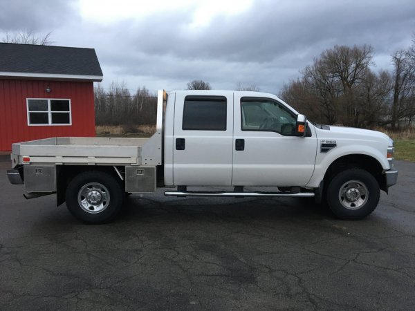

    I have owned a couple of Ford trucks with the Triton. Good engine. My current 08 F250 has the 5.4 Triton. B08ABEC1-4DAD-4FB1-9634-3CF656A5CA3C.jpeg Has plenty of power. AFE8F2ED-B468-4646-B698-6C25CAC5E540.jpeg
    I mean. I wouldn’t race will711 to the beer store with it, but ...

    No need to race , but it looks like that Bad Boy could haul many 30 packs :thumbs:
