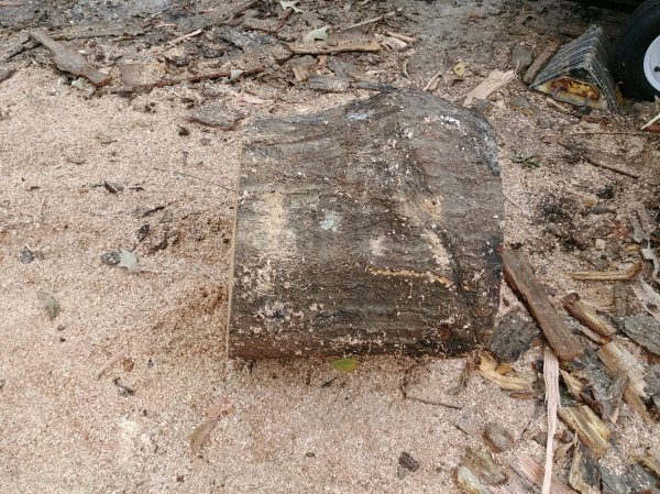

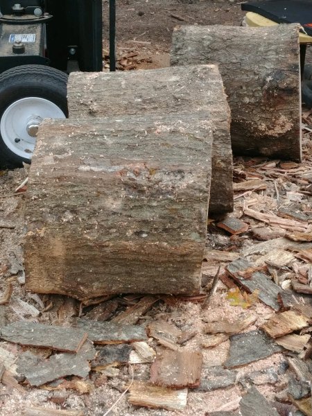

    here are two pieces that were cut angled. Might be hard to see the angle,but it's there. It's not curving, straight cut but angled to the log...

    I'm not convinced you have sharpening issues if it's not curved, nor necessarily bar issues.
    I still have issues with sharpening, and unfortunately curved cuts.
    Are you sinking the dogs in on each cut?
    Perhaps it's an alignment issue on the spikes. If one side is sticking out further, it would seem to create a natural angle.
    Have you done a "free handed" cut as someone suggested?

    Your cuts in your pics don't look curved, like you'd get with a worn bar or inconsistent raker height or cutter sharpness. I say adjust your sights a little. Just a click or 2 ;):whistle::thumbs:

    Yep, probably need to recalibrate my glasses or close one eye...:binoculars::saw::saw:

    I think huskihl hit it jeff. Those cuts are straight. Whole saw is just tilted a bit. That could easy be the big spikes throwing it off.

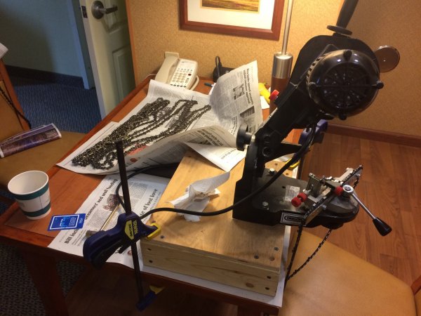

    On my Oregon grinder there is a screw that moves the inboard side of the chain groove. I’ve found that if that screw is set to the correct driver width, I don’t need to readjust the depth gage that determines how much material is removed from the tooth when changing from left handed to right handed cutters. Before having a proper adjustment on that groove/channel left and right, I was having to measure individual cutters and adjust the depth gage to get left and right cutters sharpened equally. Now I just swing the grinder around and know that the adjustment is correct. Makes sharpening a lot quicker. In the pic you can just barely see the adjustment bolt...

    That's a nice grinder, mine is a habor freight $35-40 model that was given to me...

    Thanks... I suppose, at least in this case, the more you spend, the easier it is... not always the case... As has been mentioned in other threads, when it comes to sharpening, you have to try different methods and find what works best for you. Not everyone’s experiences are the same..
