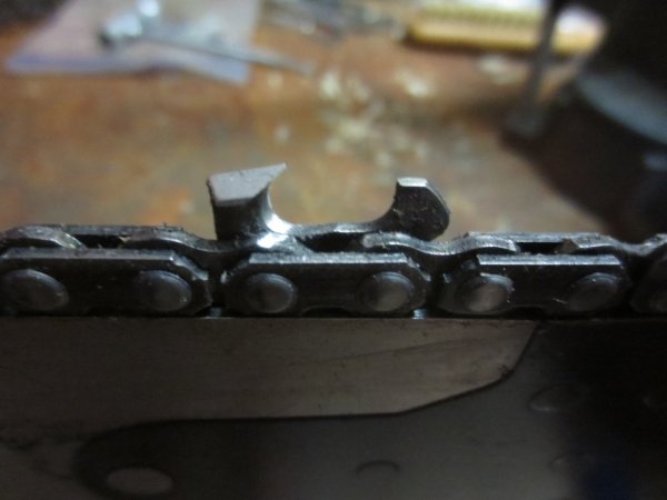

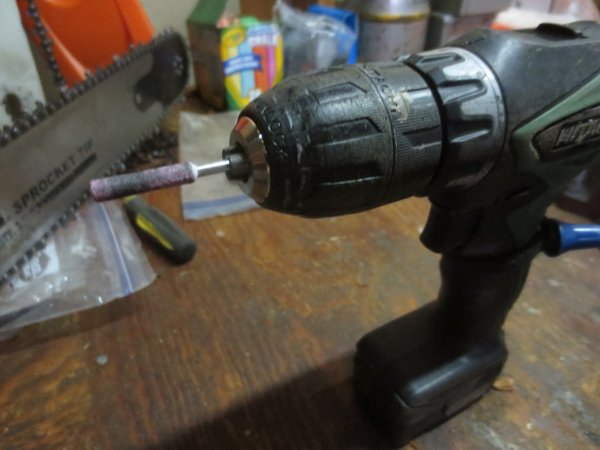

    My cheapo dremel died as i mainly used it when a chain was really dulled and/or on the 25"+ chains vs hand filing. Put a 7/32 bit in my little cordless drill and walla...chain saw sharpener. IMG_5042.JPG IMG_5043.JPG
    Seems to have put a good edge on it even though the rpm's were slower and generated no sparks while grinding. I remember seeing someone put an actual file in a drill and sharpen that way. Ill be giving that chain a run today or tomorrow and will report back.
  2. T.Jeff Veal
    29,467
    188,579
    Looks good, maybe a little deep in the gullet. I tried the file-in-drill method, have to run drill in reverse.
    I also have the Stihl 12v chain sharpener, very similar to a dremel, but has a depth gauge on it.

    22" chain i got with the 361 from jo191145 last Summer. He had an aggressive grind which i followed. Tried it out on the 500i today. Cut great but one side teeth longer as i cut slightly to the left. Ill hand file it now.

    A standard file won't work in a drill very long...the teeth are made to cut on the push stroke only...a file labeled as "rotary" would be what you'd want for doing it this way...
  5. The Wood Wolverine
    18,829
    121,185
    Standard files are not designed to be turned when used. The push stroke does the cutting, not high speed rotation. :loco: :crazy: Don’t waste your time with that...

    I remember vaguely trying it years back and realized the same.

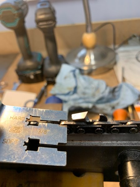

    Any pics? Something im not familiar with?
  9. The Wood Wolverine
    18,829
    121,185
    Search Oregon File-o-plate. Here’s some pics. I of course use the Husky one but I believe Still makes one.
    So with this one, you place it up against the back of the cutter in front of the depth gauge and rest it on the cutter. What sticks up through the hole gets filed smooth with the plate.

    I had something very similar made by Carlton years back. I think it was called the "file-o-plate". I used to buy chains cut from a roll of Carlton chain at the OPE dealer i did business with many years ago.

    Do you know if it works for all type of chains or exclusively Carlton?
  14. The Wood Wolverine
    18,829
    121,185
    I’ve not owned a Carlton one. But I use the Husky on all my chains with proper results. I have Oregon, Stihl and Carlton chains.

    The File-O-Plates will work on other brands of chain as long as they are of similar style.
