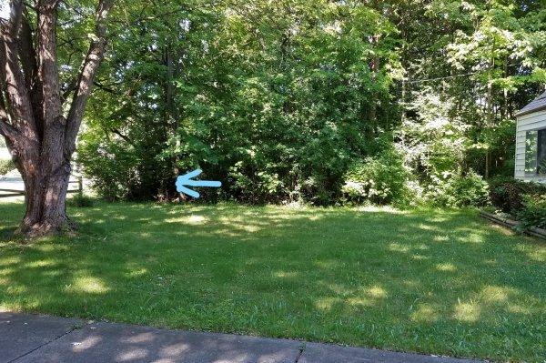

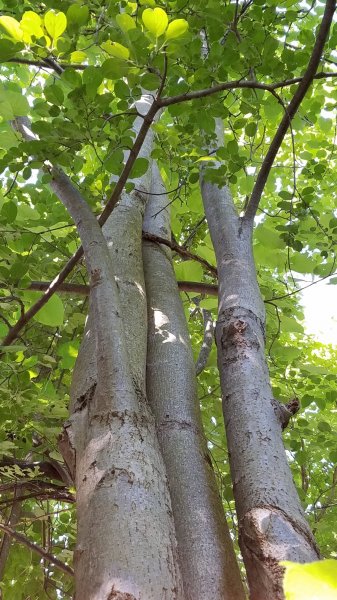

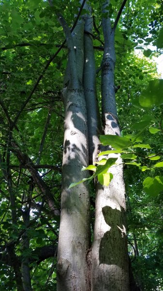

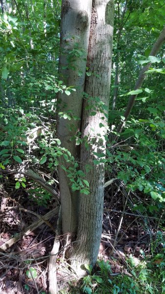

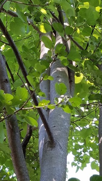

    I'm not quite sure how I'm going to get these down but gotta get em down before they get bigger, Bottom of them are 7 inch diameter .
    They are Twisted around each other at the top.
    What I'm thinkin is maybe is, get a rope up around both , make some cuts just enough to weaken them and pull em down with the truck.
    I should have taken them out when they were small.:doh:

    Power line is behind em so, they have come down toward the yard

    Actually ,I think I'll take the rails outa the fence and pull em down onto the ditch,road, that will clear the maple tree

    As long as they aren't too tangled, I'd probably try and take it apart one leader at a time. If they are really tangled I'd throw a couple heavy duty ratchet straps around it and bring it down in one shot. A pull rope is also a great idea. Poplar doesn't tend to barber chair, but that is always a concern. Lemme know if you want a hand with it.

    They are really tangled up good.
    That's a good idea , put ratchet straps around it up where they are touching each other.
    I think I can get em down alright , just leave real thick hinge and pull em down

    We get maples that grow like that.. Really hard to tell from pics. I would lean towards chain them together at 8 foot high. Get a couple good pull ropes half way up. And drop as a group..

    Yep I would make a face cut as low as you can go so. Then make the back cut and pull them over.
