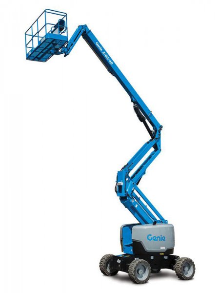

    In a lift, up in the sky, going sideways is not as much a worry as going vertical! :rofl: :lol:
    The tow behind lifts are the least expensive to rent, it's just the repositioning that's the downside, it's somewhat involved in comparison to a self propelled unit.
    The other thing I've learned from experience is the difference between a straight boom and an articulated should be considered. Dropping limbs from a height, a straight boom will put the machine further away from the drop zone.
    The picture that @ thewood wolverine posted is know as the "articulated" and in JLG's lineup there's an "A" in the model # where there's a "S" in their straight mast booms. Both (I believe) have a "J" that they offer meaning jib. That's a 6' extension that is very handy for both types. :thumbs:

    Some of the articulated ones are also known as a “Z-lift”…
    Straight lift. Generally only on the smaller machine.
    jib lift. When you start getting up there, the main boom gets jumpy when you move it, so that jib lets you have a much smaller swing. Especially when you’re over 60’ up
    articulated. Likely be dropping the tree on top of the machine with one of these

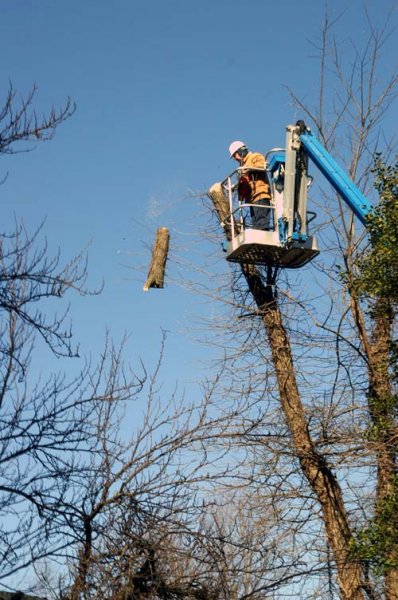

    !cid_ii_141766e888459235.jpg been there , done that . rented one about 10 years ago for $ 300 bucks and towed it home with a 3/4 ton pickup. reach was 60' if I recall correctly

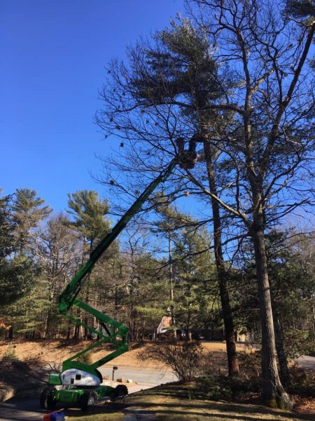

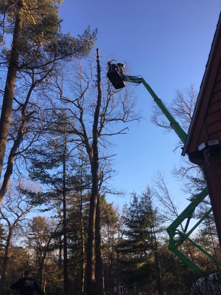

    I hired a crew a few years ago and this is how they took down 30ish tall trees on our property. The operator did wear a harness. Took him about 1.5 days and they did it in February when ground was hard and no snow.

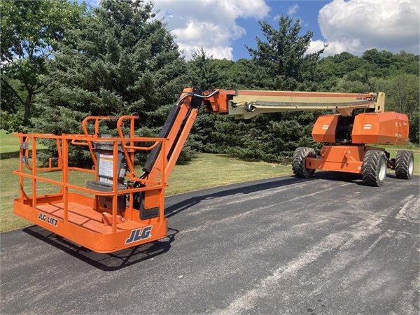

    It's not a boom lift, it's a high reach. Buddy has one that will extend to 125 feet that I can borrow if I need it. Always better to have more than required than to not have enough reach Getting ready to paint our big barn and I'll be using it for that. Already own a commercial airless, all I need to do is get up the nerve...lol

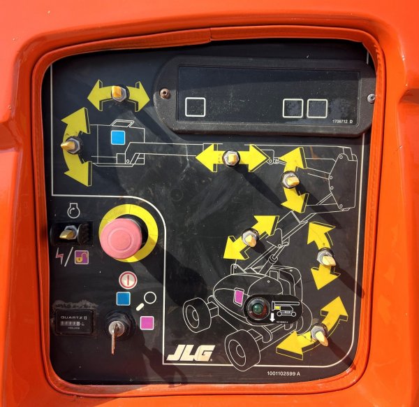

    All the JLG's I've unloaded in the past, you NEVER operate them (unload or load) from the basket. You do everything on the ground next to the machine. Used to haul them all over for Herc Rentals. Hauled some big ones too and overweight was never an issue. Hauled them on a 53 foot single drop.

    Trying to remember which controls it was that operate the drives from the ground panel. I know you can raise and lower the boom. Never seen a drive control.
