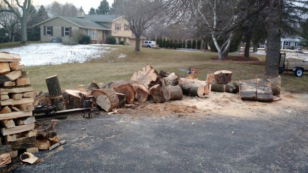

    It's a lot of work, but having the splitter lock up is not helping. I'm pretty sure the valve's high pressure port locked up. I'll crack the fitting loose some time this week.
    Oh well, I have nearly everything cut up. I'll noodle the stump piece a bit to get it manageable to throw on the splitter.

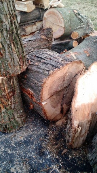

    Here's the elm round that made me hold the valve lever down too long, locking the pump. It's supposed to bleed pressure out if this happens, but the valve's been acting up, and I wasn't able to get my hand off the lever quick enough.
    Hmmm

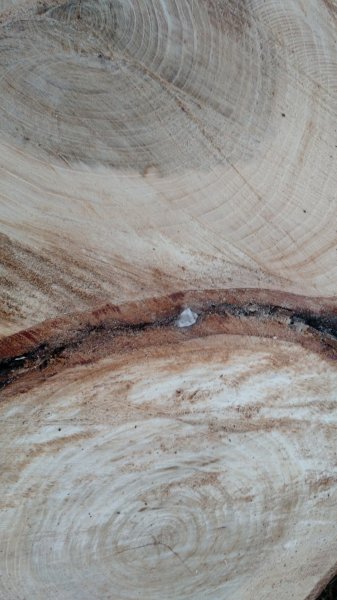

    I don't know if it was the tree service's saw that found this, or mine. I think it was not mine. I don't know what it is exactly, but it was soft enough to get sliced. It's about 3/8", and metal.
  7. yooperdave
    35,877
    225,704
    OK, OK, I'll turn around and start heading back your way!
    I think I would try popping that metal out just to see what it is, no?
  8. Horkn
    29,226
    166,831
    Yes, yes I will. It seems pretty soft for a chain to still cut through it.

    It was just a piece of rock.
    Not great for any chain though.

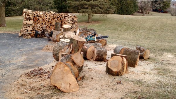

    So I finished bucking, and noodled some rounds. I used the dolkita. I like it. I like it a lot. It's definitely got more grunt than my 029 super. That stock trilink chain is kind of crappy, but it's good for ripping through trees that could be filled with all sorts of things. IMG_20170312_180521246.jpg
    I noodled the locust stump into about 4 pieces, and noodled a couple bigger rounds of elm and maple so they were a little easier to move once the splitter is operational again.

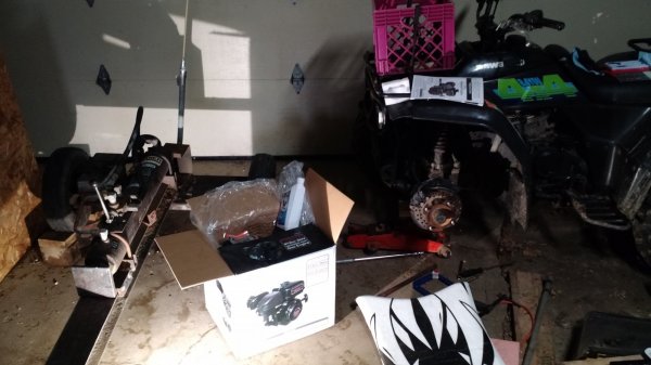

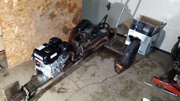

    So the Tecumseh was too wide to fit on the splitter chassis. IMG_20170318_130209469.jpg
    Predator 6.5 HP, $99 at harbor freight with coupon.
    Stuff to work on today.

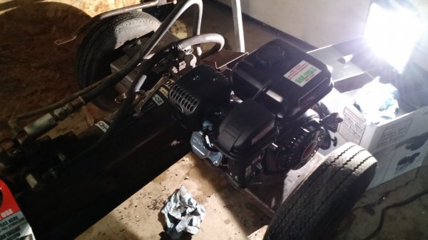

    And it did. With a new 3/4" L075 Lovejoy coupling.
    It started on the first pull. Amazing. Time for a new glarus cabin fever.

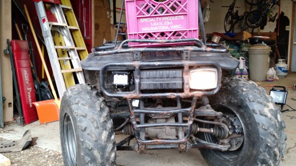

    Finishing the new u joint for the front driveshaft on ATV. My buddy started it, took the old one out, we just had to finish the job and put the new one in.

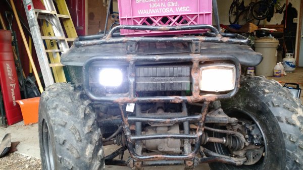

    Then to start on the LED lights for the ATV.
    I think it'll work great. I just cut out the light housing that was missing, and mounted the light on the factory bracket. IMG_20170318_172709715.jpg
    And on...
    The 18w LEDs are very bright.
