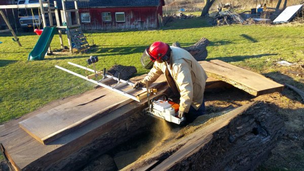

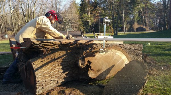

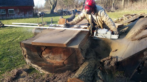

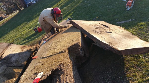

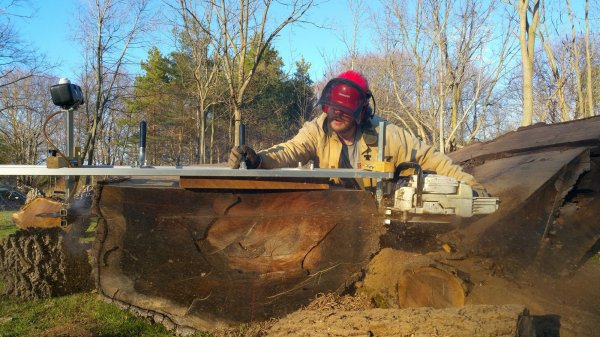

    My sister took these pics and videos last weekend while I was over there working on the Black Walnut. Stihl MS880 + 60" GB bar; 172DL 404 full chisel skip sequence chain, round ground to 10 degrees. The cut was just about 50" wide - too big for my 48" guide rails, so I borrowed a couple parts from my granberg length rails.
    Hope you enjoy, and I hope you enjoyed your Easter as well!

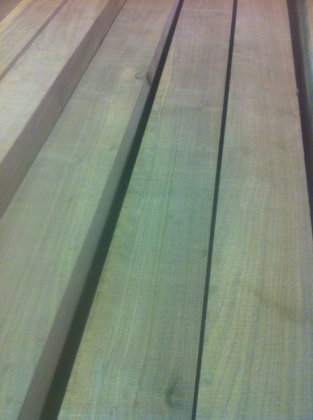

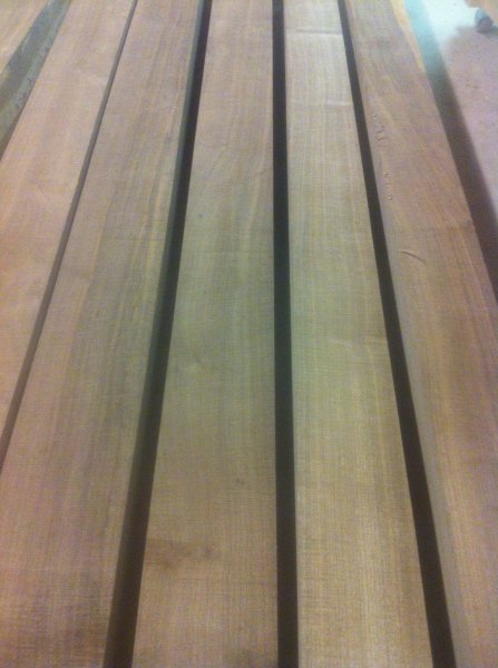

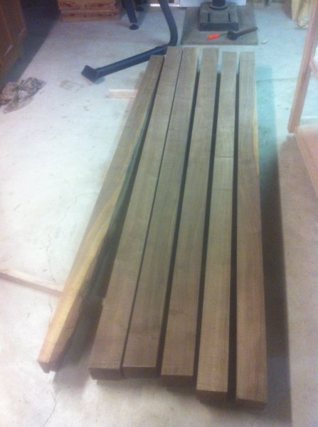

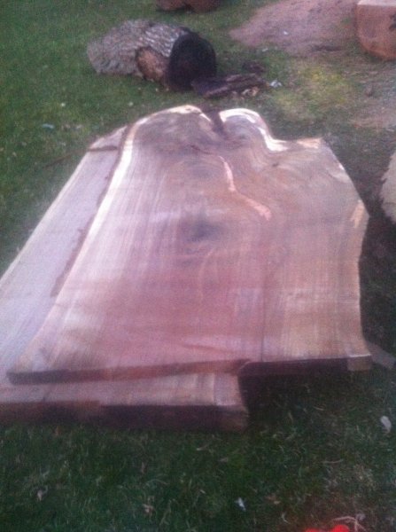

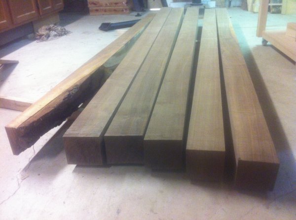

    Resawed one of the slabs into some 4x4 stock last night.

  4. fishingpol
    fishingpol
    6,502
    39,646
    Merrimack Valley, Ma.
    Any plans for that stock?

    Beautiful work and wood Sir.

  6. Shawn Curry
    Shawn Curry
    Jul 31, 2014
    3,755
    22,702
    Western NY
    Well there's not very much straight lumber to be found in this tree - that's part of the reason I ended up with it. But there's going to be tons of stuff like this that could make great tabletop or countertop slabs. So right now, this is my leg stock.
