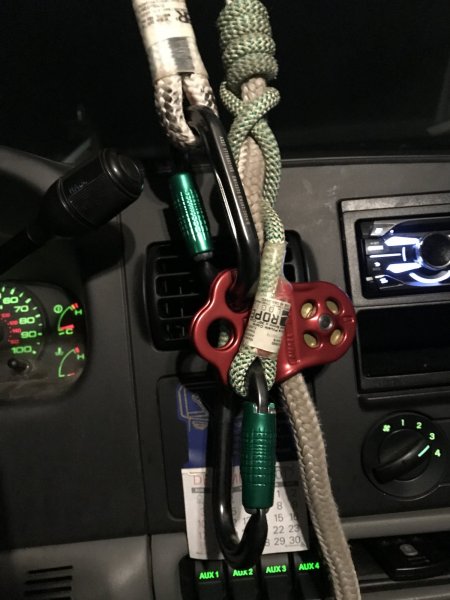

    p61 western you asked me about pictures of the new set up, I snapped this in my truck this morning since I was taking it to work to talk with one of the guys that has one and loves it. 076960A2-C280-4218-9E7A-8F991A132C4B.jpeg

    That's exactly what mine looks like too. Best climbing setup ever, IMO.

    Do you run into trouble with the knot collapsing and getting hung in the caribener?

    Joe it's my understanding that the braid portion of the vt keeps that from happening. I've never had issues with it.

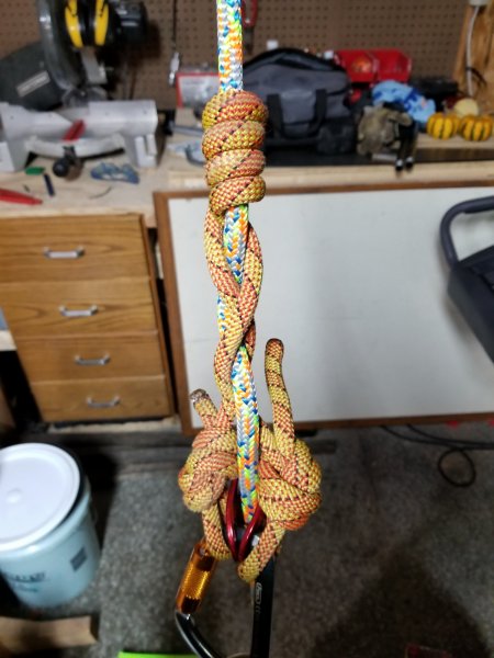

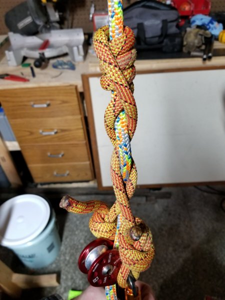

    I tie a pretty basic 4 wrap 3 braid. If i haven't set my life line before asscent, I use this set up with my climbing line as my extra flip for hopscotching branches.
    I make my own eye and eyes out of bulk 8mm accessory cord. Just a basic figure 8 bend for the eyes.
    The vt is a knot you will have to play with. If it slips too much on you, make an extra braid or extra wrap. Really depends on how slippery your eye and eye rope and life rope are. That's where making your own eye and eye can really save you because you can make it whatever length you need. This one is about 30" eye to eye and 60ish total rope length.
    I'd play with it at a low level until your 100% confident with it, and can tie it with your eyes closed.:yes:

    I think my biggest confusion is weather to start the legs top over or under on the first cross and then alternate which is on the bottom

    Stack the wraps like your making a Blake's. Then I've always gone top over bottom for the first braid then alternate. You can see it in the first pic above or this is a pretty concise example:
