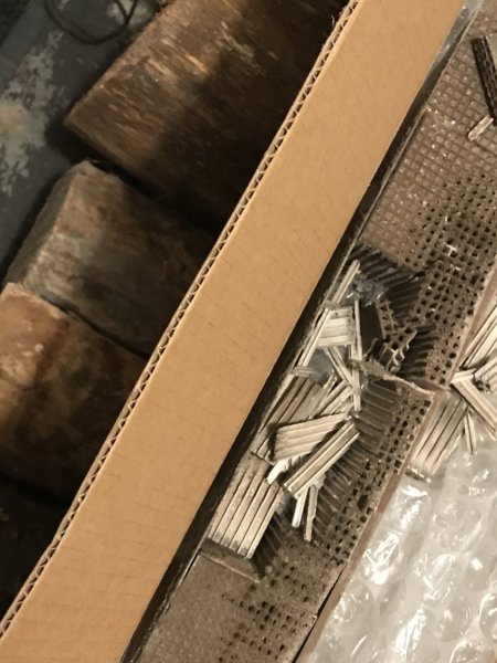

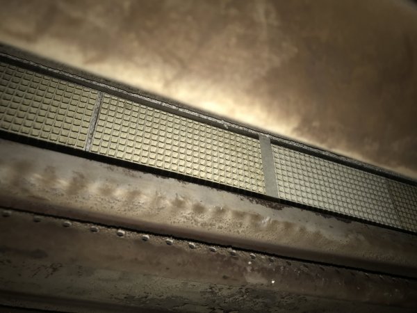

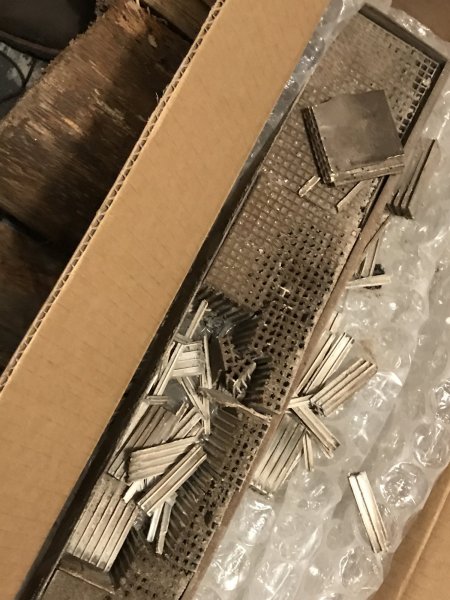

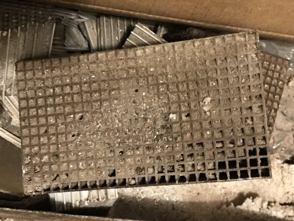

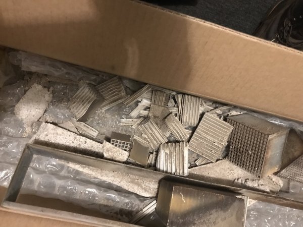

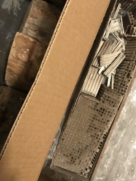

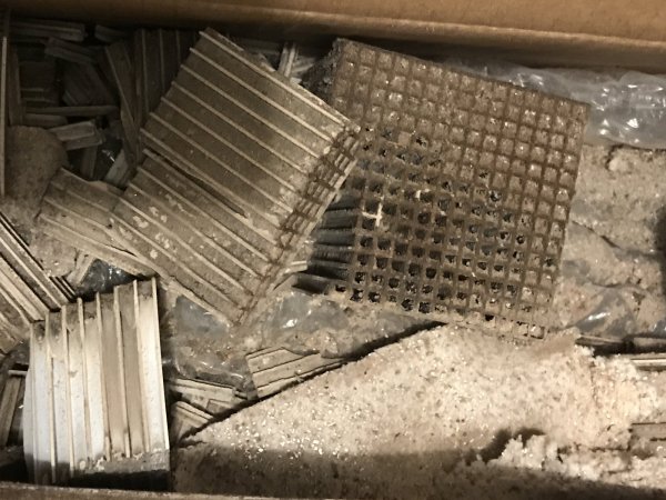

    Dealer came out and swapped my catalyst (combuster) it was trashed! Crumbling and plugged with fly ash. I only had the stove two months but I have already burned 2 cords through it. My dealer was great they came out replaced it, didn’t give me a hard time just honored the warranty no BS. Cat just popped out and the new one popped right back in, took the Technician 5 minutes (which means it would take me 2 hours). The combuster was crumbling and plugged pretty bad with fly ash... The tech said he believes a combination of thermal shock low temp burning and possibly a defective cat. No real smoking gun. Thanks to all who have replied I learned a lot from this thread. Pictures are of the trashed cat and a brand new cat.

  4. TurboDiesel
    16,241
    97,578
    You left the stove air wide open???!!!???:eek:
    Maina likes this.
  5. TurboDiesel
    16,241
    97,578
    It sounds like you're burning the stove too hard!
    The flames should move just lazily dance back and fourth. If the flames are being sucked up through the cat, you burning too hot.
    Danny Rossa and Maina like this.
