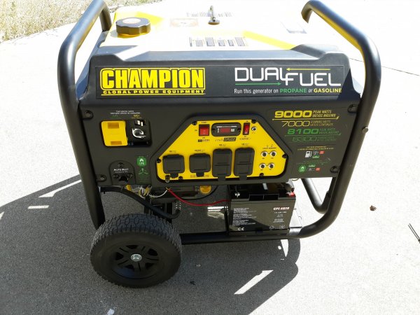

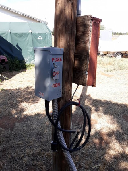

    Here is my setup. Real simple. Power comes in from the mail breakers on commercial power, into my switchbox, and out to my house breaker box. Commercial power is with the switch up, all off i the middle, and generator power is down. That was there can never be feedback to the commercial power grid.
    The generator is one I just got that has more power than my other generator, has electric start and is dual fuel. We will run it off propane mostly so when it sits, it won't have old fuel sitting in it. Got a smokin deal on it. Bought it with 10 hours on it for $500. They are right at $1000 new. 20190907_152429.jpg 20190826_104654.jpg
