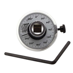

    What is a degree indicator, is that something you use if you don't have a torque wrench?
  7. brenndatomu
    25,041
    162,598
    upload_2017-8-12_23-41-2.png usually used in combination to a torque wrench. The spec generally reads something like torque to 10 ft lbs, then an additional 60 degrees (for example)
